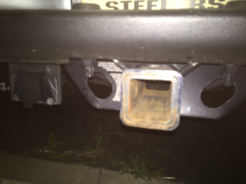

    Most TRD Sports have the tow pac. Take a pic of the wiring connector and we can tell you
  4. Jul 9, 2016 at 9:29 PM

  5. Jul 9, 2016 at 9:30 PM

    Looks factory. However someone could have added just the hitch.

  7. Jul 9, 2016 at 9:31 PM

    OEM :thumbsup:

    Great!! Thanks for the quick reply, it is there off set on the drivers side

    Yes but someone could add an oem hitch and it wouldn't have the tow package.
    But as you said most TRDs come with them. I know in my area Toyota forces you to get one.

    True, but the trailer connection makes it 99% likely to be the OEM tow pac...especially on a TRD Sport
