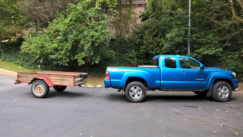

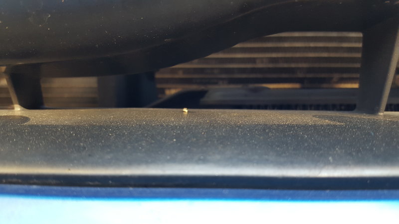

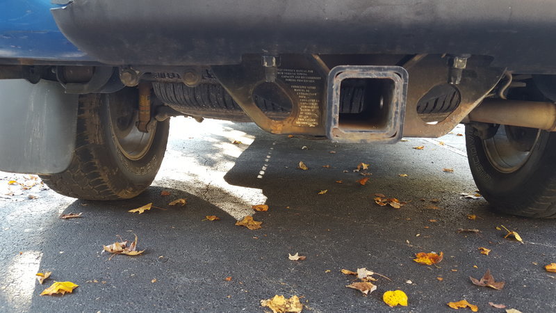

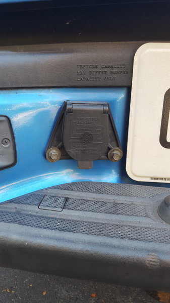

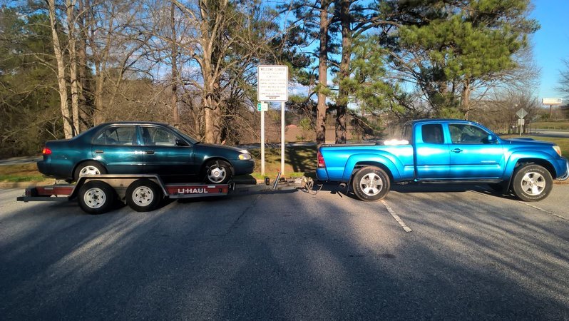

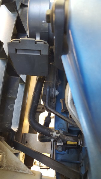

    Heres pictures of my tow package.
    Hitch. 7 Pin, I relocated mine. Transmission cooler, look through the grill on the drivers side and youll see it.
    Also pictures of my truck with my empty trailer and with 4000lbs
    What exactly are you asking/saying here?Hitch.jpg 7 Pin.jpg Cooler 1.jpg Cooler 2.jpg Tacoma and Trailer 2.jpg Tacoma towing Corolla 1.jpg

    If youve got the tow package then you have the connection for the a trailer break controller from the factory, its in the cab near the parking break, Ill take a picture of the connection later. When you get firestone airbags, DO NOT get the ones with the compressor as when it breaks your screwed, get ones with a schrader valve. Since you are lowered I have no idea what that would do your the towing capacity.

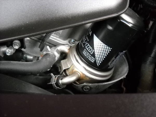

    Look at your engine. The oil filter in particular. Does it have a metal piece below the filter with two hoses? If so, that is the oil cooler which comes with the tow package.
    Tow package will be oil cooler, trans cooler (if automatic), higher output alt, larger battery (group 27 I think?), pre wired for brake controller, 7 pin plug, hitch.

    Looks like I have two hoses below the oil filter.

    That means you have the OEM towing pac. You should also have the pink fan clutch.
    That should put you at a 6500# capacity....with proper tongue weight and balance of the load.

    Sounds like you have the factory tow package. You should also have the aux trans cooler installed infront of the radiator (seen in 4th pic from Joey below the horns).
