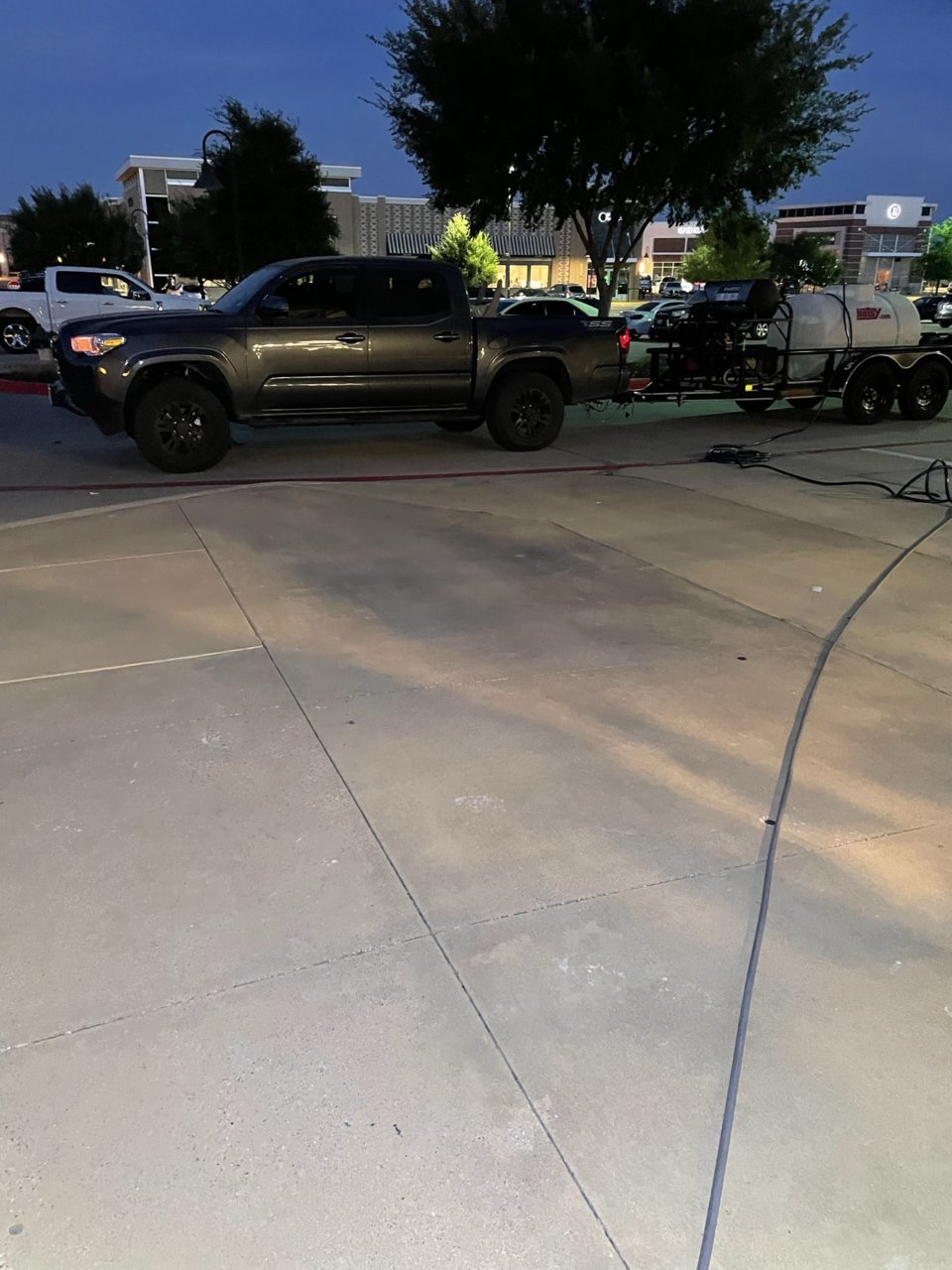

    EB441637-1946-4840-B13A-6791D714633E.jpg 2021 Tacoma TSS model 4 cylinder double cab:
    -Need to tow my pressure washing trailer anywhere from 20miles to 50 miles one way for jobs.
    -trailer weight is 5500 pounds dry and always dry when driving.
    -300 gallon water tank is 2500 lbs when filled (7900 total) but only driving 5mph around parking lots to clean sidewalks at 100 foot intervals.
    Logic:
    -V6 tacoma rated to 6800lbs
    -I4 has the same frame and transmission but weaker engine obviously. No tow package like an transmission cooler.
    -figure I can roll with this for 2-3 months until I can afford a new truck.
    Driving conditions:
    -4th gear, ECT power, 55-60mph max and RPMs kept at 3000 or less.
    -Football field distance maintained for braking from cars in front. Extremely conservative driving.
    Questions:
    1) If I maintain 3000rpms or less will that prevent the transmission fluid from overheating? I plan to install and transmission cooler asap.
    2) If the frame and transmission are the same as the V6 version what would be damaged by towing this weight (5500lbs) in the I4? I think I heard the V6 has a different clutch but I'm not sure. I change the oil every 3000 miles and it's an Iron block engine. Never had coolant overheat when towing.
    The point:
    I want to upgrade to a Tundra asap but financially I just can't right now. I know tacomas are solid and reliable and the towing estimates are made conservatively. So am I out of my mind here trying to make my business work with what I have at the moment? Believe I desperately want a new truck but this is all I can do right now.
    this is with about 120 gallons of water in the tank. Not very squatted.

    Walking speeds in a lot is fine, but getting it to the lot doesn’t sound very safe.
    I’m hoping at the very least, you have trailer brakes.
    I can’t fault a guy for working and trying to start his own biz. Seems a used half ton or greater would’ve been better than a new small truck.
    In the end, it doesn’t matter what we think, if you hurt someone you’ll most likely have hell to pay.

    okay so I've been towing 80-100 miles daily for the last 3 weeks or so. No issues with transmission or engine temperatures. Acceleration is what you expect but I just right lane it and do 60mph. 4th gear, ECT.
    Braking is "ok" as long as you're not stopping short. I keep my foot over the brake and always am looking for upcoming slowdowns.
    Point being, these trucks can punch above their weight however long term I'm not sure. Haven't done a fluid analysis. Would I recommend doing this? Only if you have to. It's a slog driving any distance because you feel the trailer the whole time and are more on edge about braking. The trailer will push on you. I will be upgrading to a Tundra soon. Should make those long tow trips safer and way more comfortable.
    I commend my 4-cylinder taco for taking the abuse. Of course I regularly change the oil at 3,000 miles with mobile 1 synthetic formulated for towing.

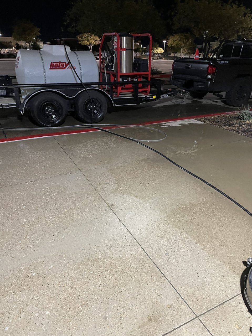

    Thats a sweet hotsy unit. Is that a hot water or just massive PSI/sidewalk cleaner?

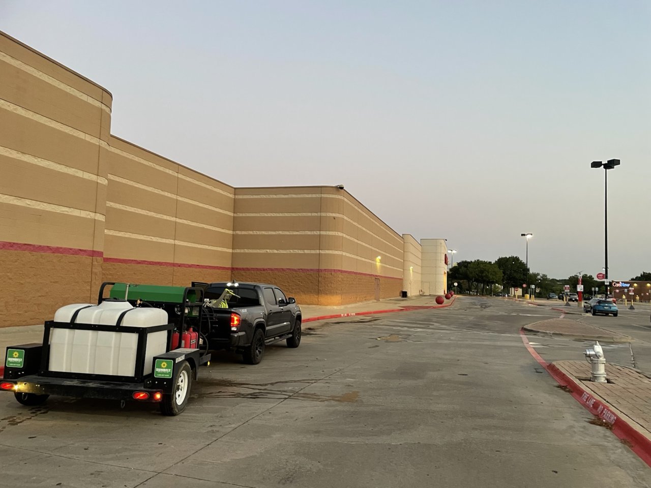

    Do you have 3 different trailers? Cause in every picture you have a different set up.

    It’s a Diesel burner. There is a large coil set up inside that the water passes through and heats up to about 150 or so depending on the unit. They have a Honda engine most the time that runs the pump.
