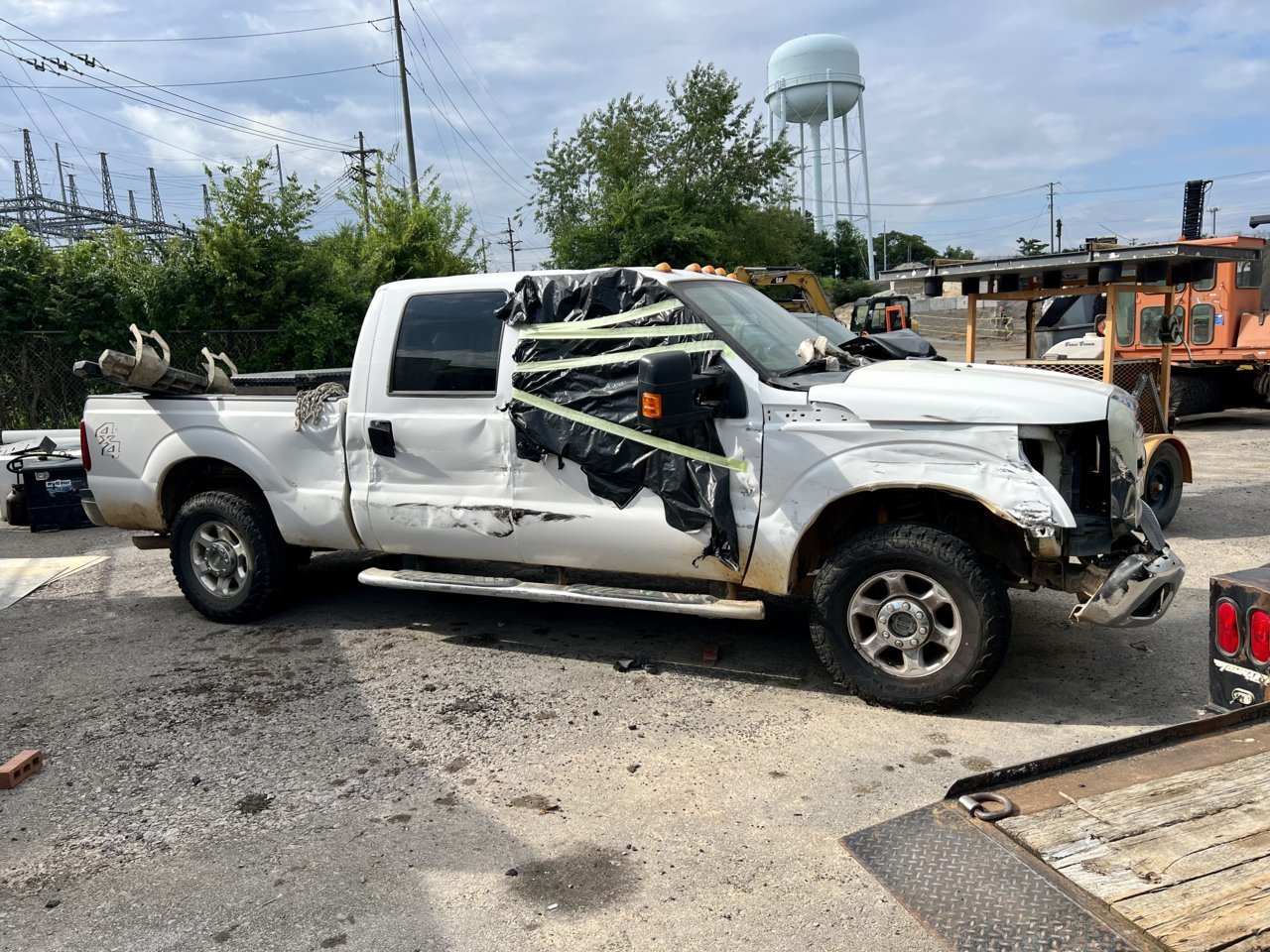

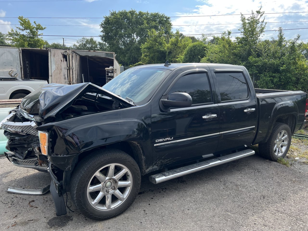

    "Well, looks like I got a couple projects...... We have not had any wrecks and maintain a very good safety record at work. This past Friday was not very kind to us. Both of these vehicles were totaled yesterday. Salvage value of $1,500 for the 2012 Sierra Denali, $1,000 salvage value for the 2012 F-250. I bought both for salvage value.
    2012 Ford F-250
    Had a 6.2 gas engine and 389,000 miles. Our guys were going down the interstate when a semi just absolutely came over in their lane and had no where to go. They somehow kept it off the guardrail and only damage is to left side. I paid the salvage value of $1,000 for this truck.
    2012 GMC Sierra Denali
    Trucks has 418,000 miles on it. All original, truck runs great and zero problems. It has the 6.2 in it. We wanted to see how long this truck would go before engine or trans went out and is the oldest truck we have. That plan has changed. Driver was in back city roads in North Knoxville. Came to an intersection where the other street had a stop sign. Other car did not even begin to stop at stop sign. Our driver had to swerve quickly to miss the car, squared up a telephone pole on the corner. I bought this for the 6.2 engine. I would like to swap into my 87 square body."

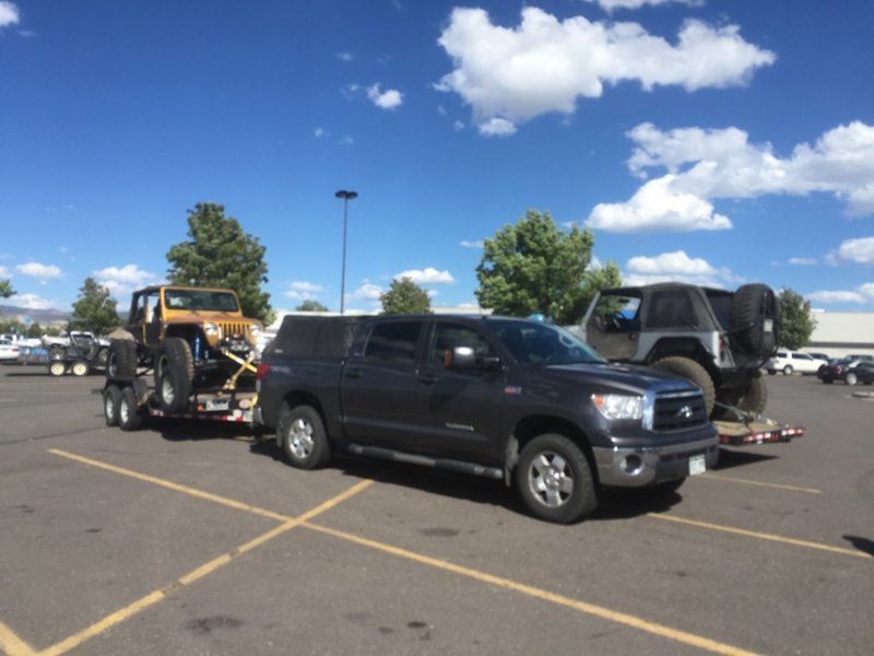

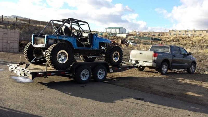

    This is what I was towing with my Tundra.
    This is 8K, maxed payload.
    This is the heaviest at 9K I could possibly pull without being so embarrassing and stopping every 125 miles for fuel.
    This was at 8200 lbs. Trailer is lighter than my HD trailer and crawler is 1000 lbs less.
    So well within what you plan on towing. I haven't been to Denton TX in a while, but I do remember some passes and hills. Nothing like CO, but still can work a truck.
