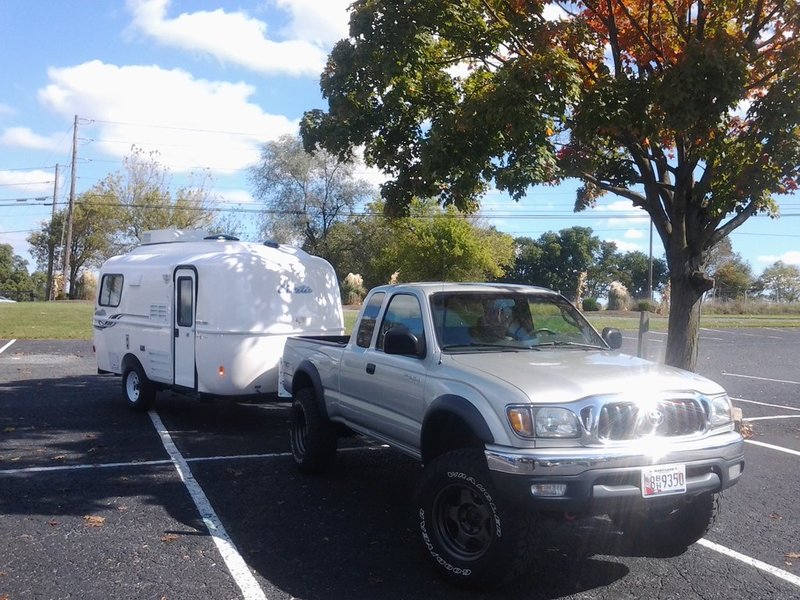

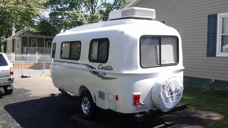

    I tow my 17ft Casita and i use a Curt sway bar, it tows & handles nice.
