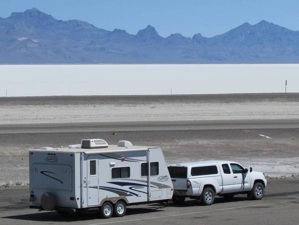

    Goober
    Goober Earthlings are fun to watch!
    Dec 20, 2010
    #47990
    691
    Utah - Why just have only one?
    '11 TRD Off-Planet AccessCab
    This is the same weight of the trailer I towed with my Tacoma. It's good match. Truck works to pull it but won't kill it.[​IMG]
    July 4th weekend on the Bonneville Salt Flats.
