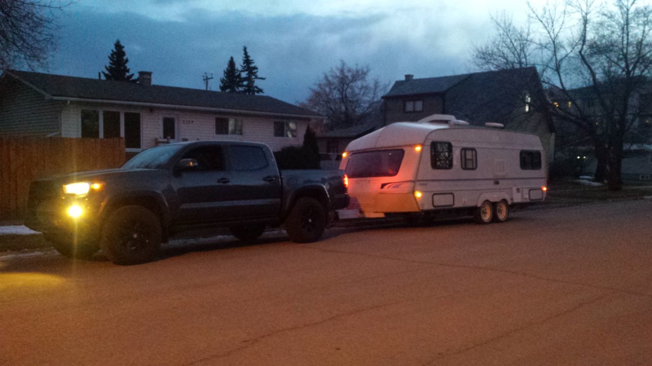

    Here's mine. Just get the wdh. It makes everything better.

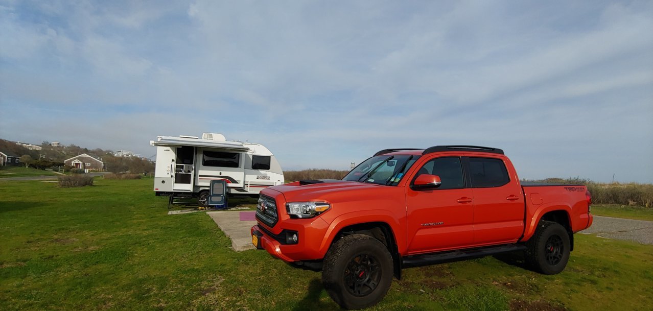

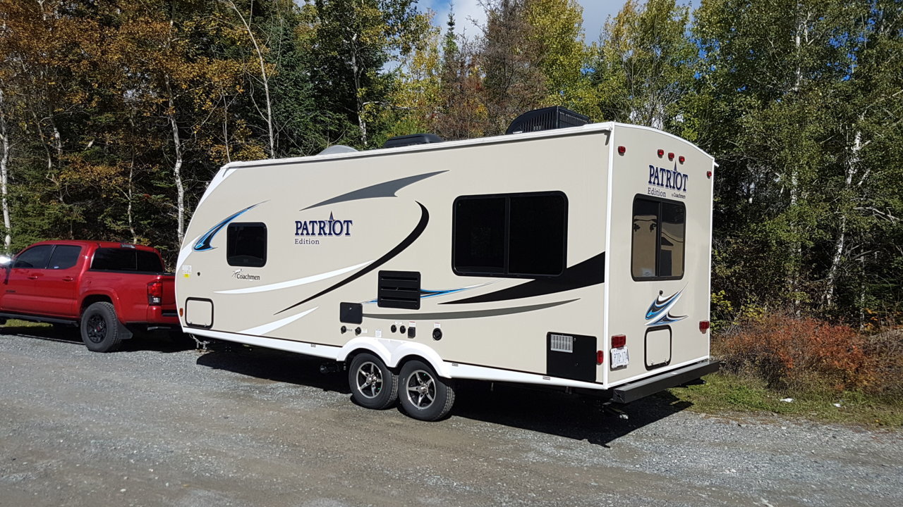

    20190421_175149.jpg 20ft and 7ft wide. When I was picking it up at dealer the service guy suggested I try towing without the WDH. My tongue is now around 450-500 and the trailer is 3700 loaded. I took it on a 6600 mile trip and then another 3000 mile trip through all types of weather and it tows great. Two things about the WDH , it does transfer more weight to your front axle and the trailer axle. My trailer axle is pretty maxed out as it is so I didn't want any more weight there and a WDH adds about 90lbs to your tongue. Also if you get a scale and weigh your tongue you will probably find that it is heavier then what the dealer tells you as a previous poster stated. If your tacoma is stock it is probably already squatting with the Cap. I have some Sumo springs. They 20 minutes to install and help it squat less.

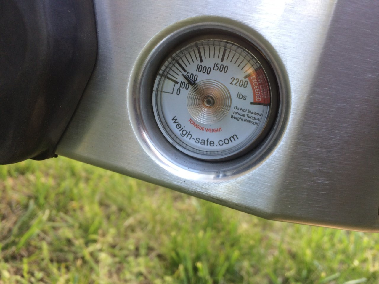

    right at 3500lb actual loaded scaled weight and 420lb (with out LP tank but dual 6vbatteries) tongue weight (middle pic is a weight safe hitch)
    the tires the camper delivered with new were barely adequate for it unloaded weight, i’ve upsized the wheels and tires as a result.
    you’ll see the spec sheet from manufacturer is not real accurate......
