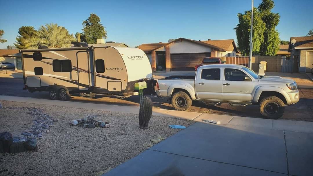

    Hi! We have a 2007 Tacoma with the tow package, rated 7500. We have a 3800 lb trailer and the truck seems to really struggle. Were talking about just getting a smaller trailer (maybe closer to 3000 dry) but my husband is thinking it still might struggle even then. Trying to decide if we should look into a Tundra instead or even something else (Ford, Ram etc), but we've both always been fans of Tacoma. We did buy this one and it already had a 3" lift and 33" tires, so we were also considering that could be impacting it.

    It looks like the trailer is nose high. Does your hitch have enough drop for the trailer?
    The front of the truck looks high also. Do you know the tongue weight of the trailer?
    Trailer and truck should be close to level when loaded and ready to go.
    7500 lb tow capacity seems generous.
    What is the loaded weight of the trailer? 3800 lbs sounds like the dry weight.

    Also, without even looking up the specs that trailer looks quite a bit heavier than 3800 pounds. You might want to take it to the scales. I wouldn't be surprised if you're over 5500 pounds there.
    3000 pounds wet weight, which is really the only weight that counts, is small. Really small. As in your looking at either a pop-up camper or teardrop trailer.
    Lift and tires will affect towing. A lot.
    I'd recommend getting more truck.

    The tow capacity with the tow package is 6500lbs. Betting that trailer is closer to 5k lbs once loaded up(if not over that) you’re lifted, and you’re towing a big heavy square air brake behind you.

    Sorry correction, my husband said 6500 lol. Not 7500. He said because of the V6 and tow package. And yes 3800 is dry on that camper so we were going to go to something smaller. But it sounds like a teardrop or pop-up is probably going to be the best option if we keep with Tacoma?

    Looks like you have a weight distribution hitch (bueno). Looks like it is not set up properly (trailer and truck both nose high). If you adjust the handling will improve.
    What won’t improve is your towing performance. A Tundra (or any full-size) will handle any trailer better for power, braking, stability and passenger comfort. Get a Tundra and you will be much happier towing.
