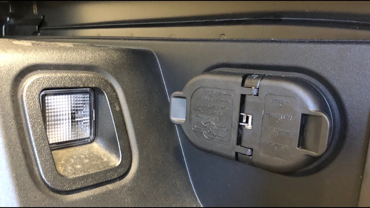

    First make sure your truck has the tow package, it was optional up to 2018.
    If you have the 4/7 electrical plug shown below in your bumper you have the package and the truck has the wiring for the electric brakes. You still need to add the brake controller.
    Toyko Joe and shakerhood like this.
