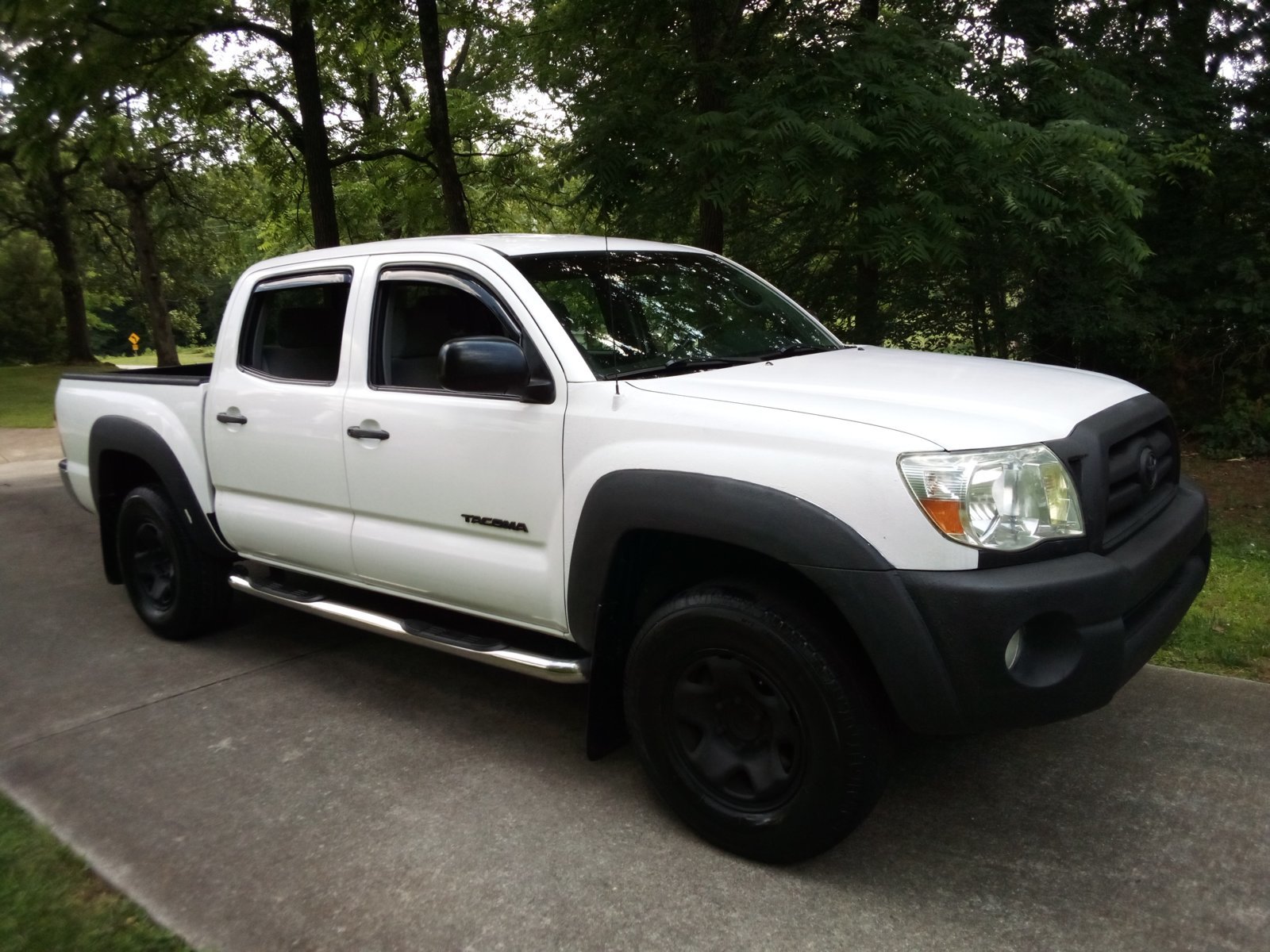

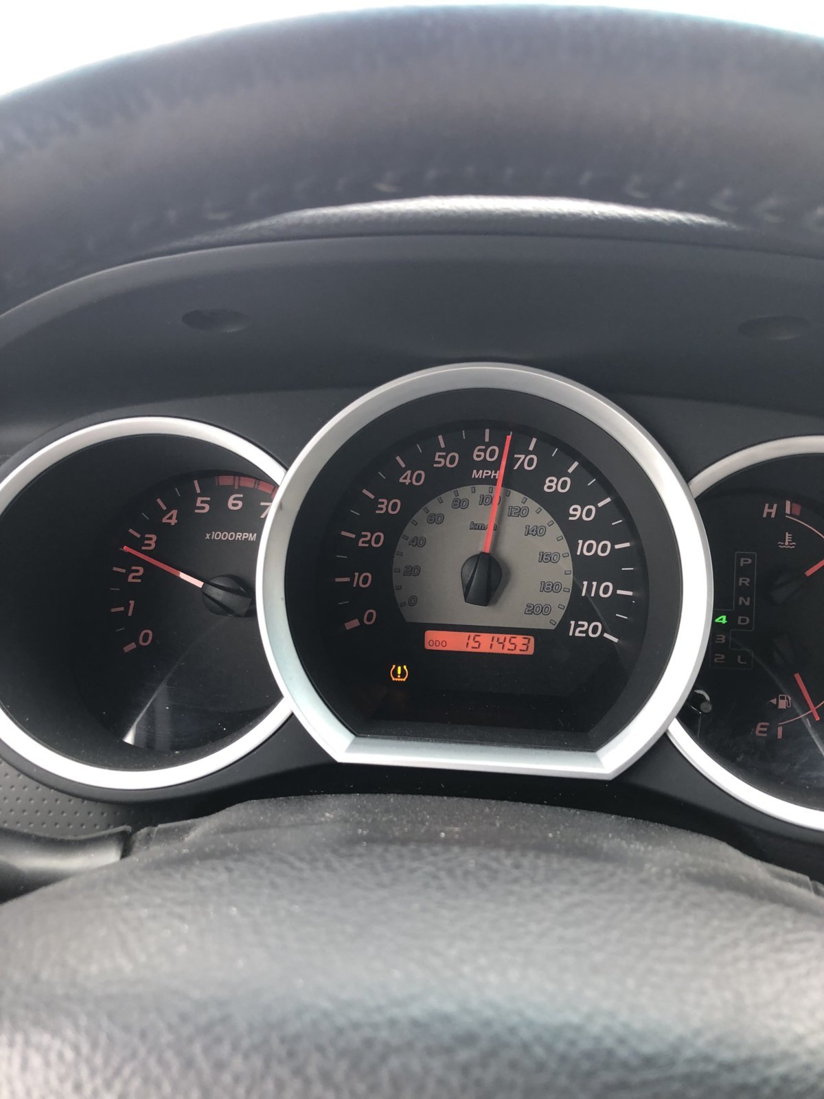

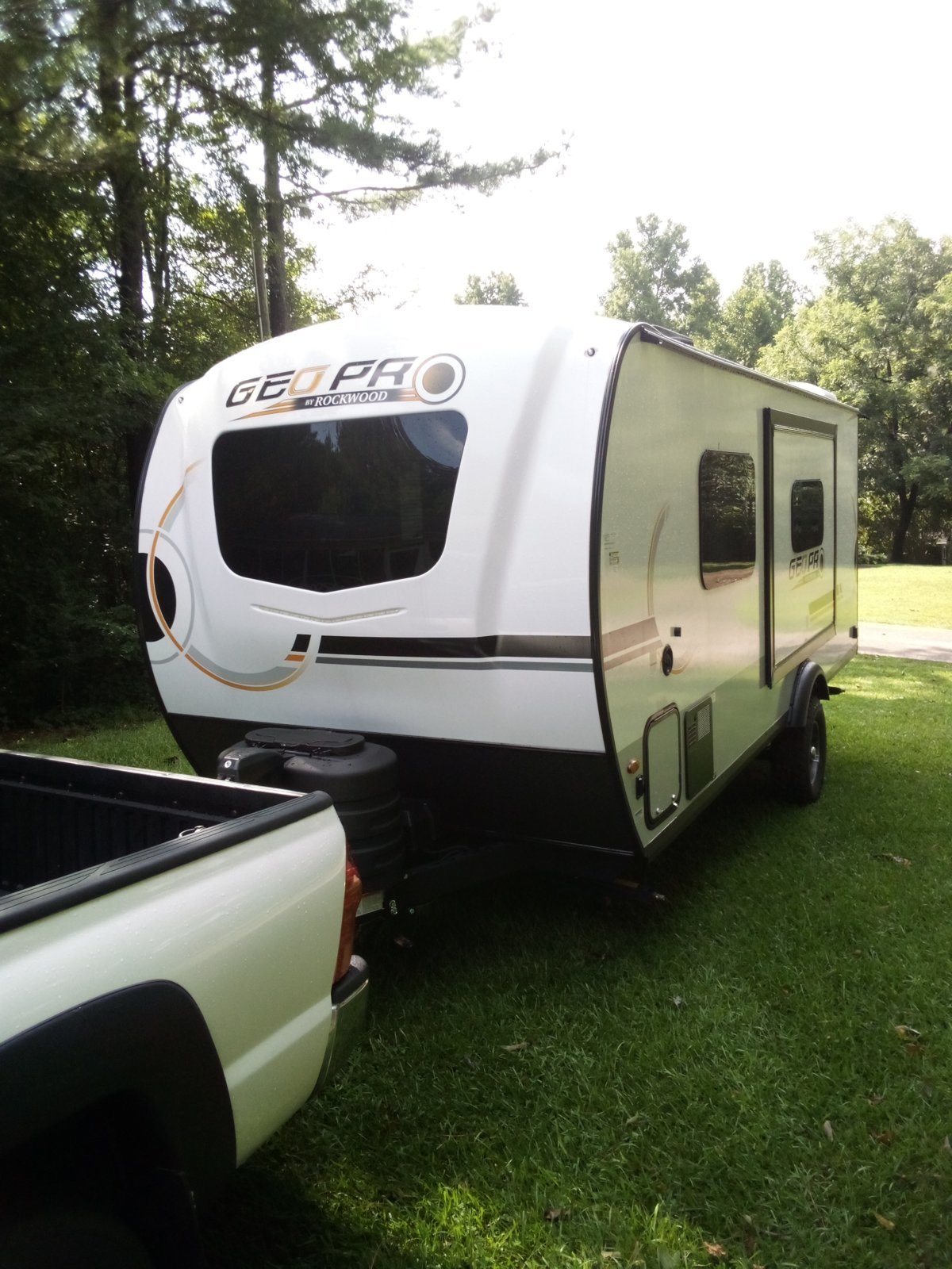

    2007 Tacoma V6 automatic 127,000 miles. I'm towing a Geo-Pro 20 foot 3500 pound camper.
    Question, it does fine on flat ground but hills present a challenge. Is running it in 4 th gear pushing 3000 rpms going to dog my truck out ?
    Thanks in advance.

    We don’t know how much weight you have in your truck (passengers and equipment) nor do we know the loaded weight of your trailer. Generally add 1000 lbs to determine gross weight of the trailer. So you are towing 4500 lbs or so plus weight in the truck. That is doable but is a lot of weight for aTaco. Don’t know what you mean by dog your truck out but on hills you are going to be slow and struggling somewhat. Drive in the right lane and get use to people passing you. Keep your truck out of D 100% of the time while towing. Repeat do not drive in D while towing that trailer. Drive in 4 and on steep or long grades and winding mountain roads you may have to drop down into 3. Keep your rpm’s up. When your truck is doing a lot of gear hunting drop it down to 3 or even 2.

    3K RPM is my average towing a 3500# off road travel trailer ('21 DCSB TRD Sport Auto). I have driven 12-14 hrs/day at 3K RPM average through TX, OK, CO and WY without issue. As others have stated: transmission temps are more important... stay out of the overdrive gears as the Tq Converter is not locked in 5th and 6th. You're good.
