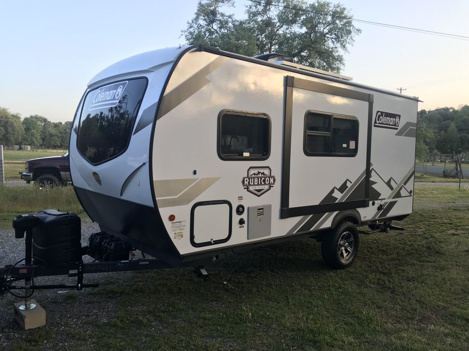

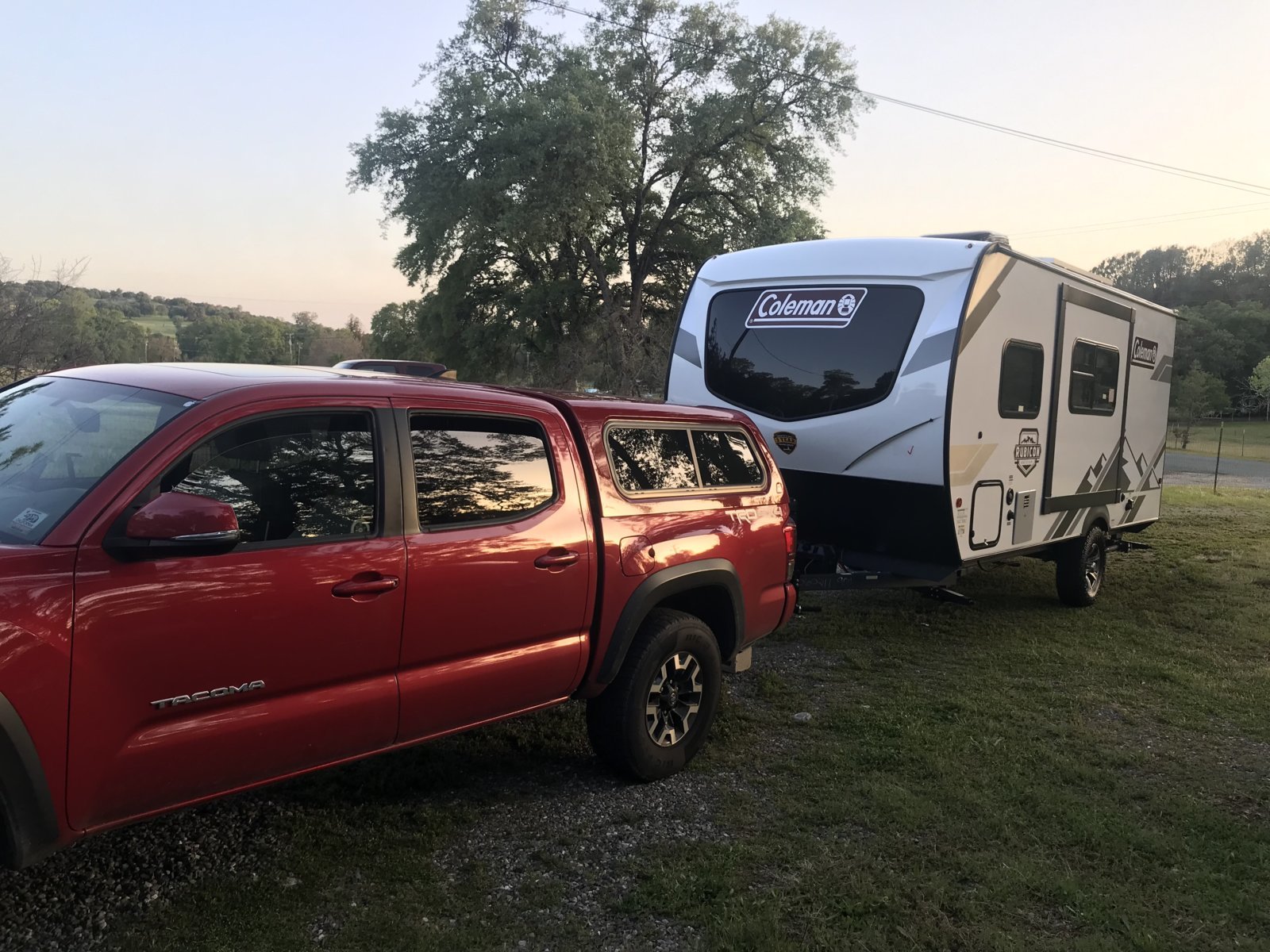

    I've shared my experience with towing. I'll do so again here.
    My wife and I bought this 2022 Coleman Rubicon 20' trailer. Single axle, supposed dry weight is #3800. In August 2022, we towed it from northern California to eastern Kentucky, mostly on highway 40. My truck got 17 - 18 MPG before that trip. I averaged 9 MPG towing that trailer. It had maybe 300 pounds of clothes, dishes, food in it. Most of that 2400 mile trip I spent in 4th and 5th gear. Never made it to 6th, not even once. Got down to 3rd plenty of times going over the many mountains out west.
    Initially, I was thinking that even at maybe 4100-4200 #'s, it was just too much for my truck. But after posting this same trip report here, someone suggested it was much more likely the wind resistance of the trailer, as it is very tall. I agree that is most likely the main MPG killer for my truck. more so than this trailer's weight.
    These pics were taken at our place back in CA the day after we bought the trailer.

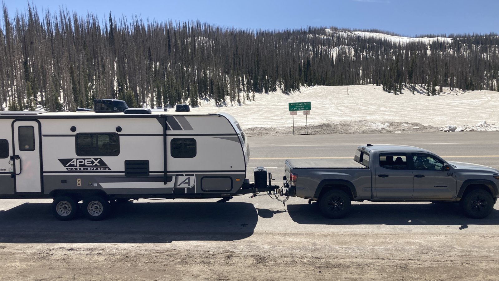

    Just about to set off on a 5k mile round trip on Sunday to the East coast, I averaged 11.5mpg last year over 8k miles but those miles were all done West of Denver with lots of mountains, this trip I should get even better mpg as there's no mountains. Current combined weight is 10klbs.
    With the rig you're talking about you will likely run out of payload in the truck before maxing out any of the other limits, especially with other passengers. Put all cargo in the TT over the axle. My recommendation is to use the redarc brake controller and Anderson wdh with sway built in.
    Photo at Wolf Creek pass 10,800 ft elevation.
