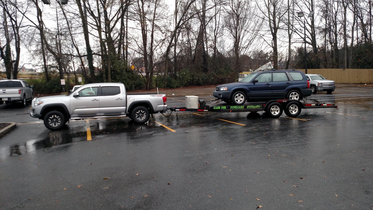

    I towed my 3500 pound car trailer with a 3300 lb small SUV loaded on the trailer from Chattanooga to Atlanta. On level roads the RPM's were about 2700 on steeper grades went to about 4,300 at 65 miles per hour. I had installed the large rear bump stops I purchased from etrailer. I don't see any problem pulling a heavier load.
    TOMRR and Dr. Mantis Toboggan like this.
