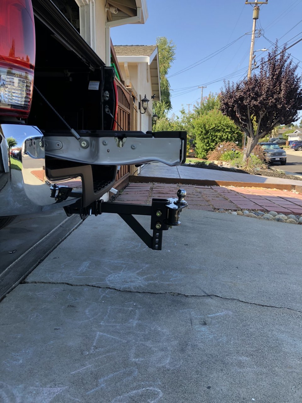

    Good idea. What's the distance from center pinhole at the hitch at the truck to center of the ball that attaches to the trailer on this hitch you speak of? The longest ball mount I've been able to find is 16" center pinhole to center ball mount and supports 6000lbs which is plenty over what my Rpod fully loaded will be. I know towing with the tailgate down is really frowned upon and I definitely understand the risks. But it would be nice to know if the option was available in the rare occasion I want to haul a few dirt bikes and tow the Rpod at the same time. This would help me decide if the short bed was doable for my situation. I love the plus sides to the shorty over the negatives for a daily driver, offroading, parking, but only if I can make it work for all my needs.

    Let me go measure that for you. The issue with the tailgate down is turning and contacting the jack. Did that on my old Tacoma pulling the boat out of the water.

    From the center of the pin hole to the middle of the ball is approx 13". Its a 6K Equlizer and when connected to the trailer I can lower my tailgate.

    Awesome, I found this one looks pretty long. with the ball attached looks like it'll be longer than 16" maybe 17~18" which would be great. any chance you could also measure the distance from the center pinhole on the hitch at the truck side to the end of the tailgate when its in the down position? I think with a long setup like this it could work out. I guess I could always remove the jack while towing its only 3 bolts to hold it to the trailer.

    Distant from the ball to the tailgate is 5"
    Drop bar appears to be one foot long.

    Awesome, thank you for all your help. I'm thinking with that even longer hitch mount it will work out just perfect.

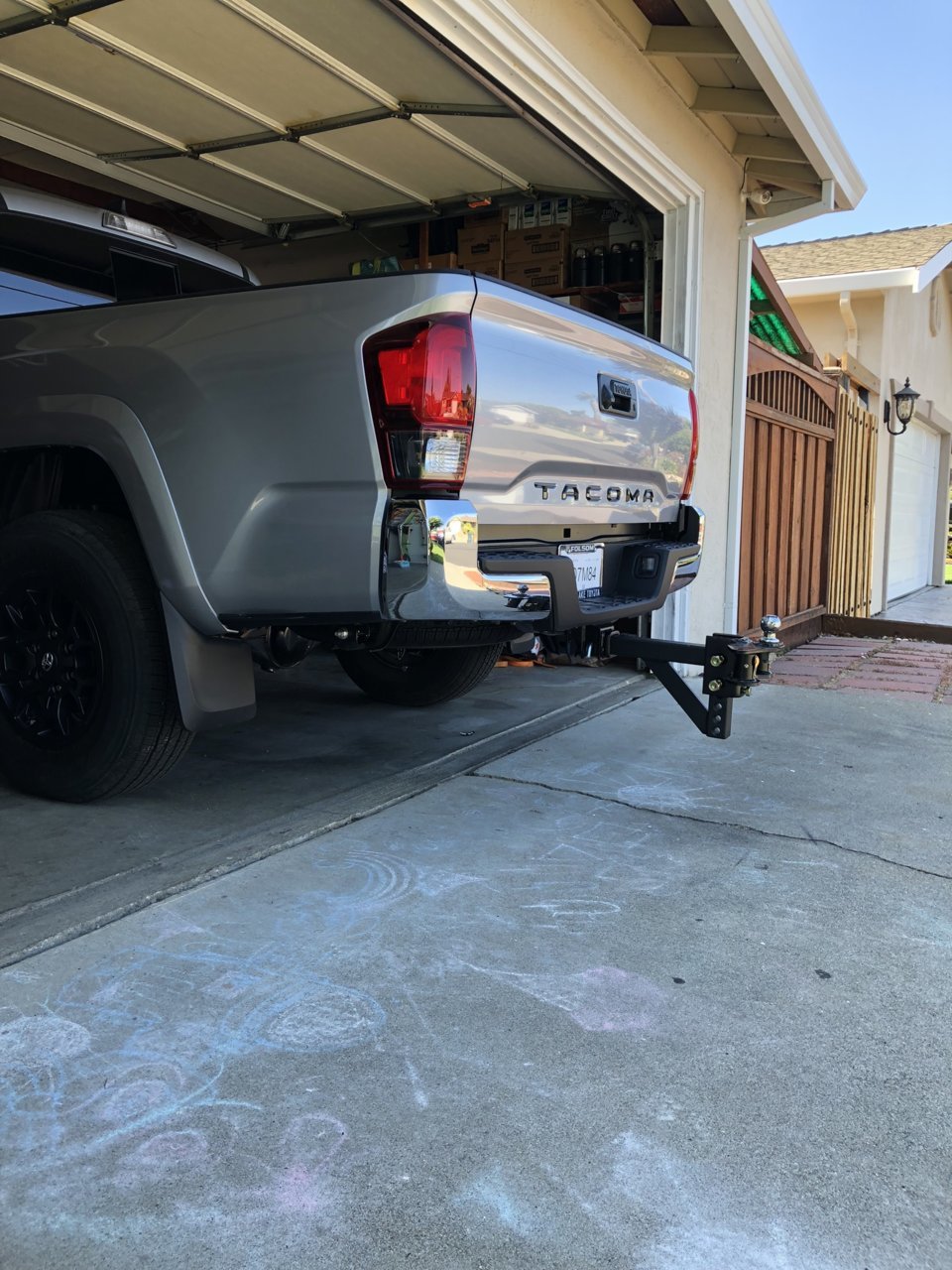

  18. Aug 9, 2019 at 8:57 AM
    #38
    blitzkrieg3002
    blitzkrieg3002 Well-Known Member
    May 30, 2016
    #188296
    1,217
    Rick
    California
    2019 Tacoma SR5 4x4
    Your right I owe you a cold one! here's my setup, I'm hoping the long hitch doesn't put too much stress on the frame, this hitch is HEAVY. Very solid unit, I think it's gonna work out great for towing with the tailgate down! I had to cut about 2-3 inches off the bottom of the hitch for more clearance.

  19. Aug 9, 2019 at 10:06 AM
    #39
    Ruggybuggy
    Ruggybuggy Well-Known Member
    Oct 11, 2015
    #166403
    3,177
    NW ONT, CANADA
    2020 Tundra SX
    The oem Tacoma hitch is over built so I dont think you will have an issue. Also the rpod isn't that heavy and your using a wd so it helps with the tongue weight.
