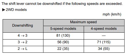

    3. Drive in "S" mode (I think I have a 2nd gen) for hills and grades so you can keep the transmission from hunting gears and overheating. This will increase RPM's and lower MPG's but you're better off.
    4. Minimize brake usage for steep and long down grades, shift down and let the truck do the work. You'll be amazed how little you use the brakes when doing it correctly. Just know you will probably be passed by non-towing vehicles but you won't have any braking issues or premature wear. I find 3rd works really well on most steep grades and keeping the speed around 55-65.
    Here is an image from the 2nd gen manual to give you an idea of speeds in gears.
