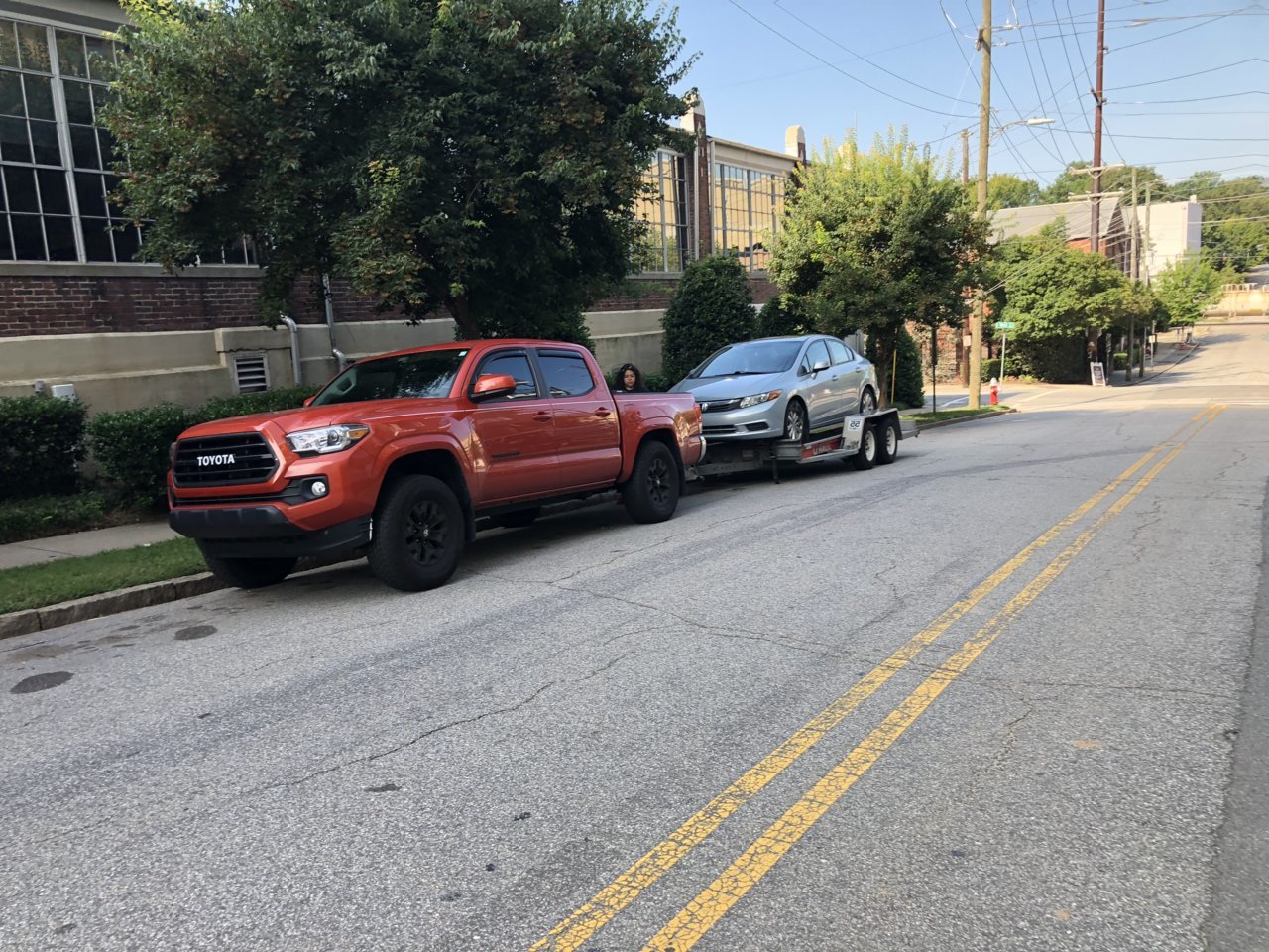

    I towed a 1968 Chevelle on a car trailer, with my previous four-cylinder standard Tacoma from Maryland up the East Coast. The thing never even broke a sweat.
