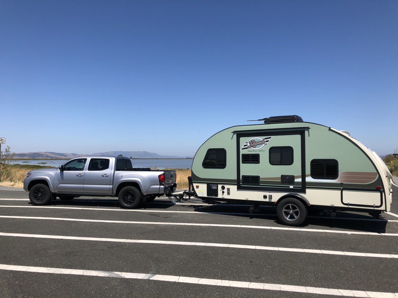

    C0F730E7-D020-4C61-8EB7-4FDAB5C66DBA.jpg I tow a 20ft Rpod 182g Dry weight is approx 3100lbs and about 3800lb fully loaded. I use a WD hitch and Airbags. Tongue weight is about 450lbs. At this weight the Tacoma tows it fairly nicely but definitely can feel it. I’m not sure I would want to tow too much larger. I’d try hard to keep it under 5000 fully loaded if at all possible if I were to ever upgrade my trailer.
    havn’t towed it yet since the 5.29 re gear but think it will be a huge improvement.
