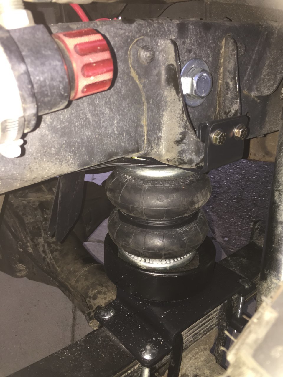

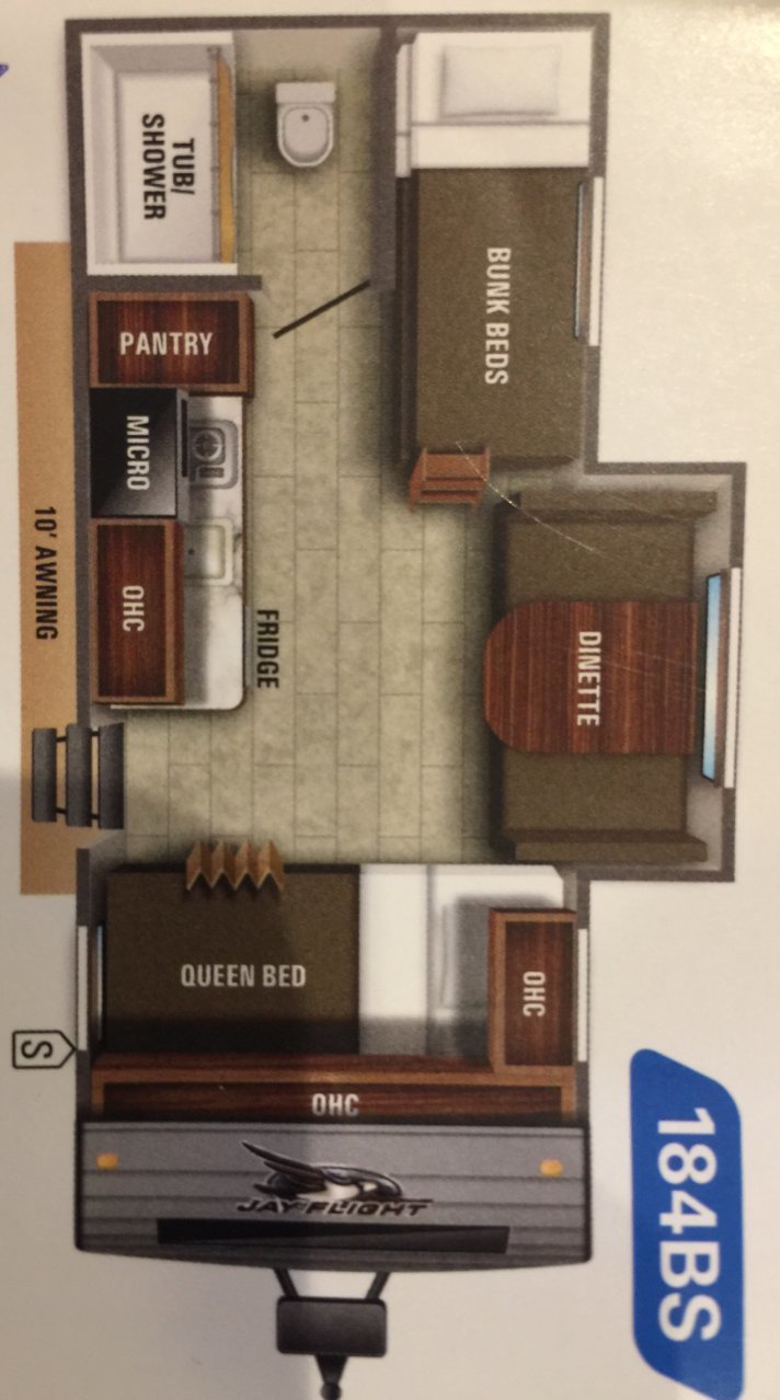

    I went with the Jayco 184BS. I did NOT want to max out the towing or carrying capacity. Braking would be extremely dangerous at that point. 3500lbs dry weight. 340lb hitch weight. spent a few hours putting on airbags. Picking it up this Friday. Seems to be perfect for my wife and 2 1/2 yr old. I also had them throw in a double-sway and leveler bar kit for the hitch and the brake controller with free install, plus $1k off the total price. Truck has 4.88’s, 255/75/17’s and is tuned.

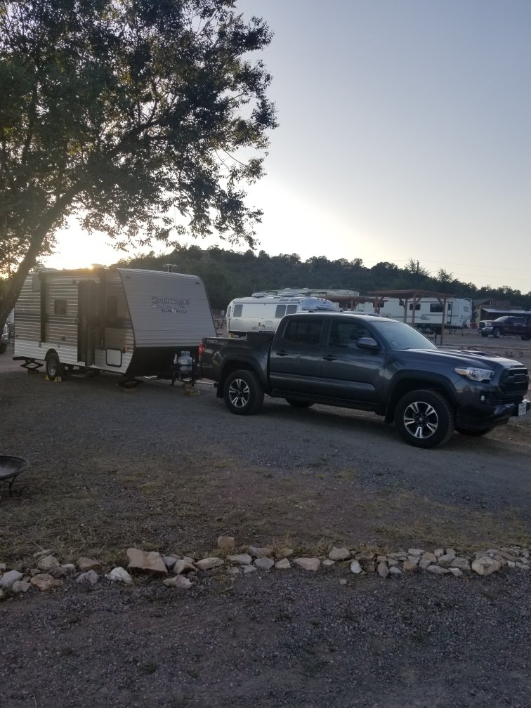

    I have a KZ Sportsmen Classic SE 18ft I pull around regularly dry weight is 2580 lbs according to the sticker, I'm sure its a little more than that. I always empty the tanks before moving it unless I'm heading to a site without water, then my fresh tank is full. I travel pretty light, few pairs of clothes, some beer, fishing poles, some dried food, etc. Never weighed it loaded but I probably should. Anyways, I couldn't really imagine towing anything larger. The truck handles it fine, but you DEFINITELY know it's there. I could only imagine something larger wearing my ass out towing it for 8 hours to the next camp site.
    It's not spacious, but my wife and I and 2 dogs have lived out of it from time to time while traveling or when our AC/Heat went out in our house and we needed a little time saving to afford replacing it without using credit cards. It worked well. I doubt this trailer meets your 4 season requirements so I guess my point with this post is that maybe you should look at something a little smaller/lighter if you plan on keeping the Tacoma. Otherwise it looks like you need to upgrade your truck.

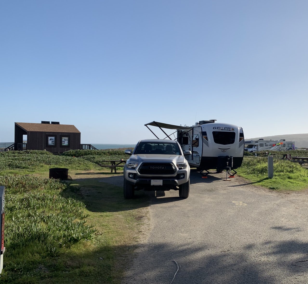

    We just bought a Geo Pro 19FBS back in Feb. 3150lbs empty, 4500lbs loaded up. The Tacoma pulls it fine. We paired it with an Equalizer WD hitch and a Tekonsha brake controller. Overall really happy with the set up. The entire line of Geos are under 5000lbs fully loaded.
