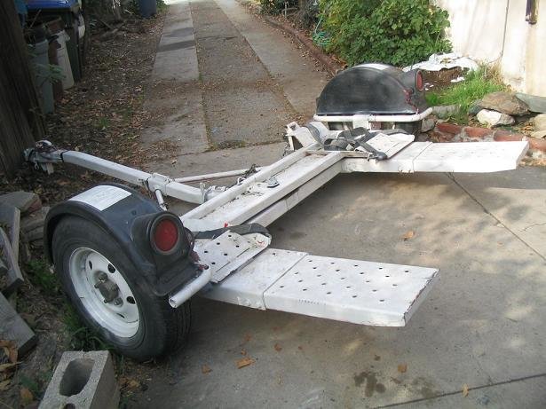

    if thats not an option, this is option #2...
    if i have to use this^^^^, are there any special things i need to do to prevent damage to the truck? do i tow it rear end on the trailer or front end? does the truck need to be in neutral?(auto trans)
    anything would be helpful because ive never used a shitty dolly before.

    If you don't so option 1 I think you can do option 2, but not sure. It needs to be rear wheels up, but if you're 4x4 I don't know if you can do it without a lever shifter and manual hubs

    may have to remove the driveshafts for option 2. Not 100% sure but read the manual in the taco and it will tell you how it can be towed.

    If you have to go with option #2, tow it front forward and disconnect the rear drive shaft. Leave it in the transfer case so you don't spill lube all over and properly secure it the the bottom of the truck to keep it from falling out.

    disconnect it at the rear diff right? and leave everything else connected?

    Yup...
