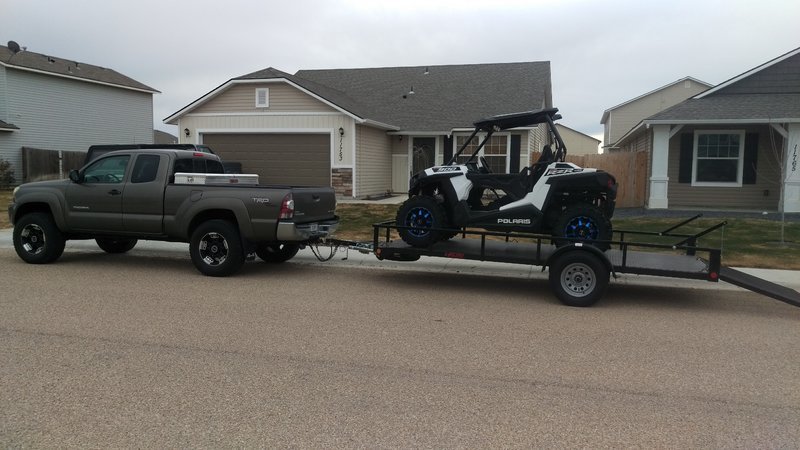

    Jet has 15% off with first 3 purchases and free shipping. Best deal I could find. Was just hoping for a lower price..quite the expense for a piece of rubber ya know? Anyway, looked at my truck earlier, has the 4 leaf pack tsb, took the sandbags out and raised another inch or so. Gonna hitch up tomorrow and have a neighbor drive his rzr on it and see how it looks.

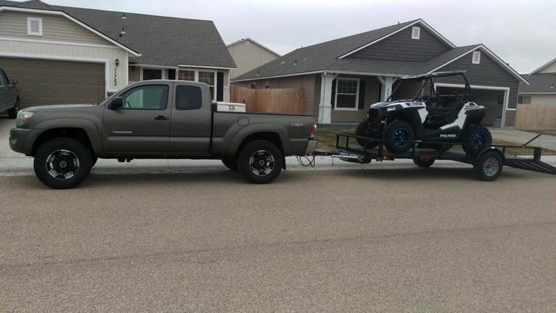

    Had the neighbor throw his rzr on..should have had him backup and level it out but this is what it looked like. Rear when down roughly 1.5"

    It doesn't look to bad from the pics. But you will put more weight in the bed of the truck maybe and the trailer. I would at least go with the timbrens or helper spring from Helwig (,https://www.suspensionconnection.com/1518-tacoma-helper.html?gclid=CKK5i7_frtICFY6FswodQXMH2g) to avoid the rear from sagging to much. I would go with the helper spring, it will give you a better ride with and without the trailer in tow. BTW, I like the wheels on the truck.
