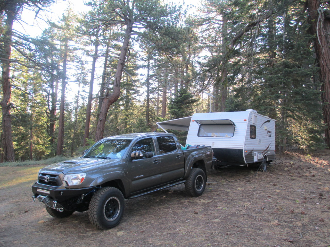

    I tow this all over the US. 30 psi in the truck. 40 psi in the trailer. 11 different states with no problems.
