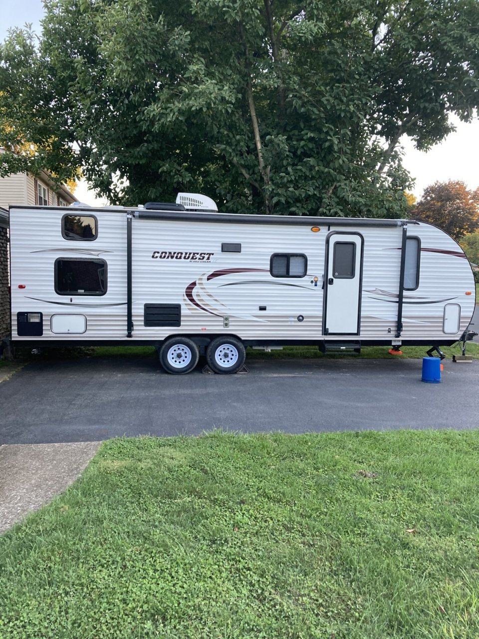

    D90EC2AD-CF61-46AE-9B21-7842330C4C13.jpgHaving towed this 25 footer twice a year since 2014 isn’t bad BUT once you get pulled out in front of or need to stop in a hurry.... that becomes a cheek clinching moment and makes you think twice about how many people around you don’t give 2 shits what you’re towing or why you’re driving the speed limit with caution ..... but once you’re at your destination it’s all good!
    stay_the_trail[OP] likes this.

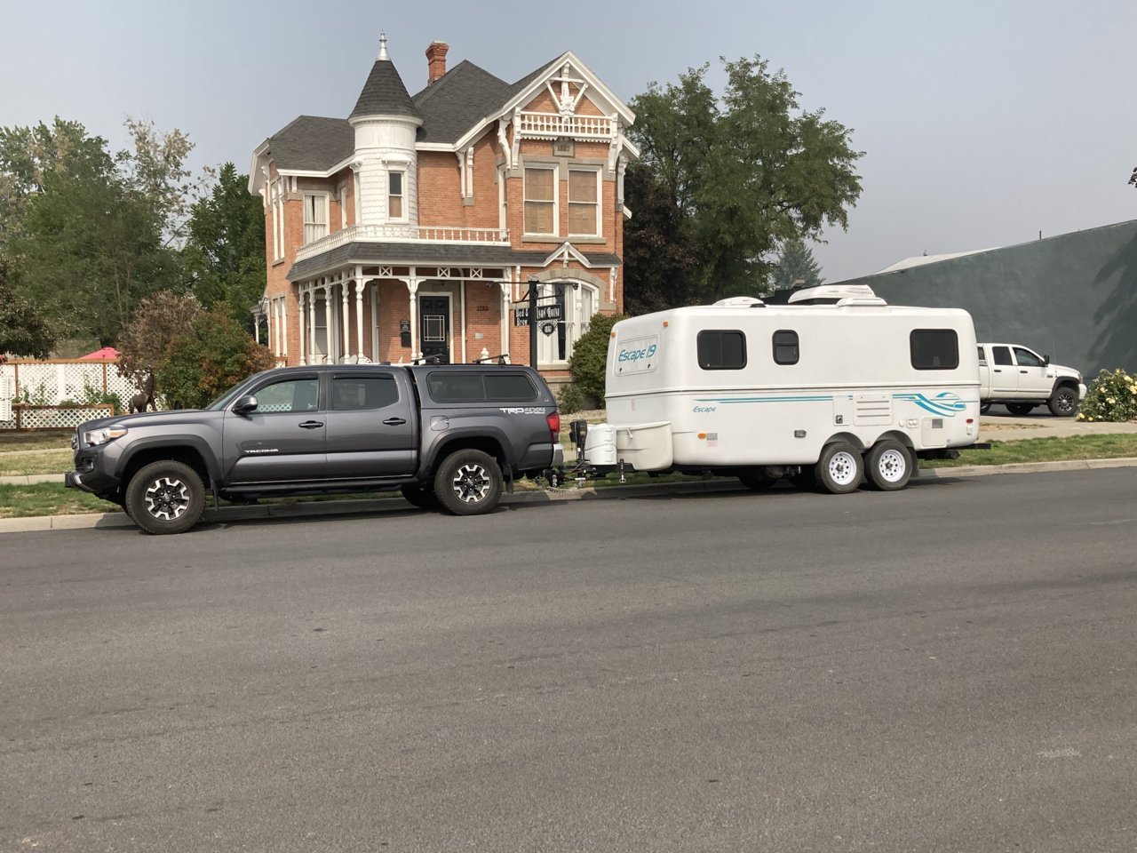

    Thats a beaut. That will be my next trailer in 5 years, they build them a few hours away from my place.
    But even that lightweight fibreglass Escape, I’ll be buying an F-150 V8 (currently my work truck) when it gets returned to the lease company. I like to be 50% of the rated capacity max.
