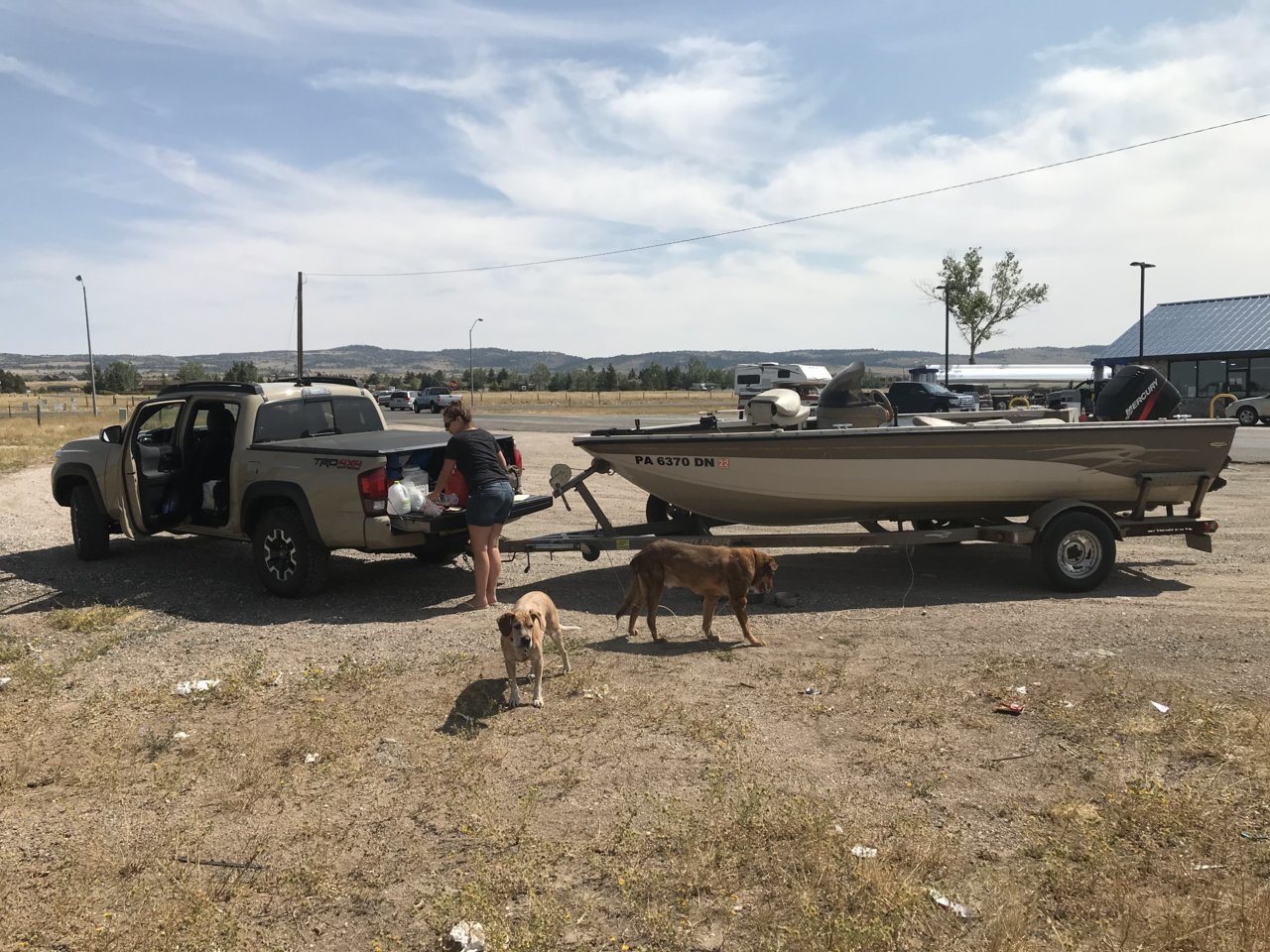

    I think we passed each other at a gas station both gassing up. I had a boat on mine.
