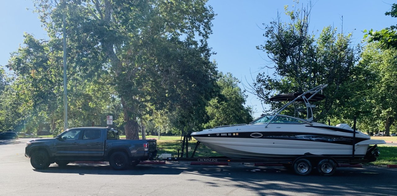

    I was asked to tow a good buddies boat (24.5ft boat, double axle trailer with bump brakes). Very short tow. From ramp where he docks it, to repair shop 15 miles away. I could avoid highways and take side streets if needed. We figure all in weight is high 5000's.
    im experienced towing with my old Suburban, Not this little guy.
    Am I crazy?
    will let you know how this turns out, unless im talked outta being a buddy soon. ha

    It will handle that weight for 15 miles easily. Tongue weight may be an issue if you don't have a WDH set up. Slow and steady. Doubt you woul want to go 5 plus hours with it but 15 miles should be fine

    Thanks, Gentlemen. Makes me feel more confident. No hills on the route, except the boat ramp.
    In case this turns into an occasional event (for more free boat rides), I think I'll take the advice for upgraded shocks and brakes.
    if any product advice there, I will take it. Willing to spend for good stuff since truck is so new.

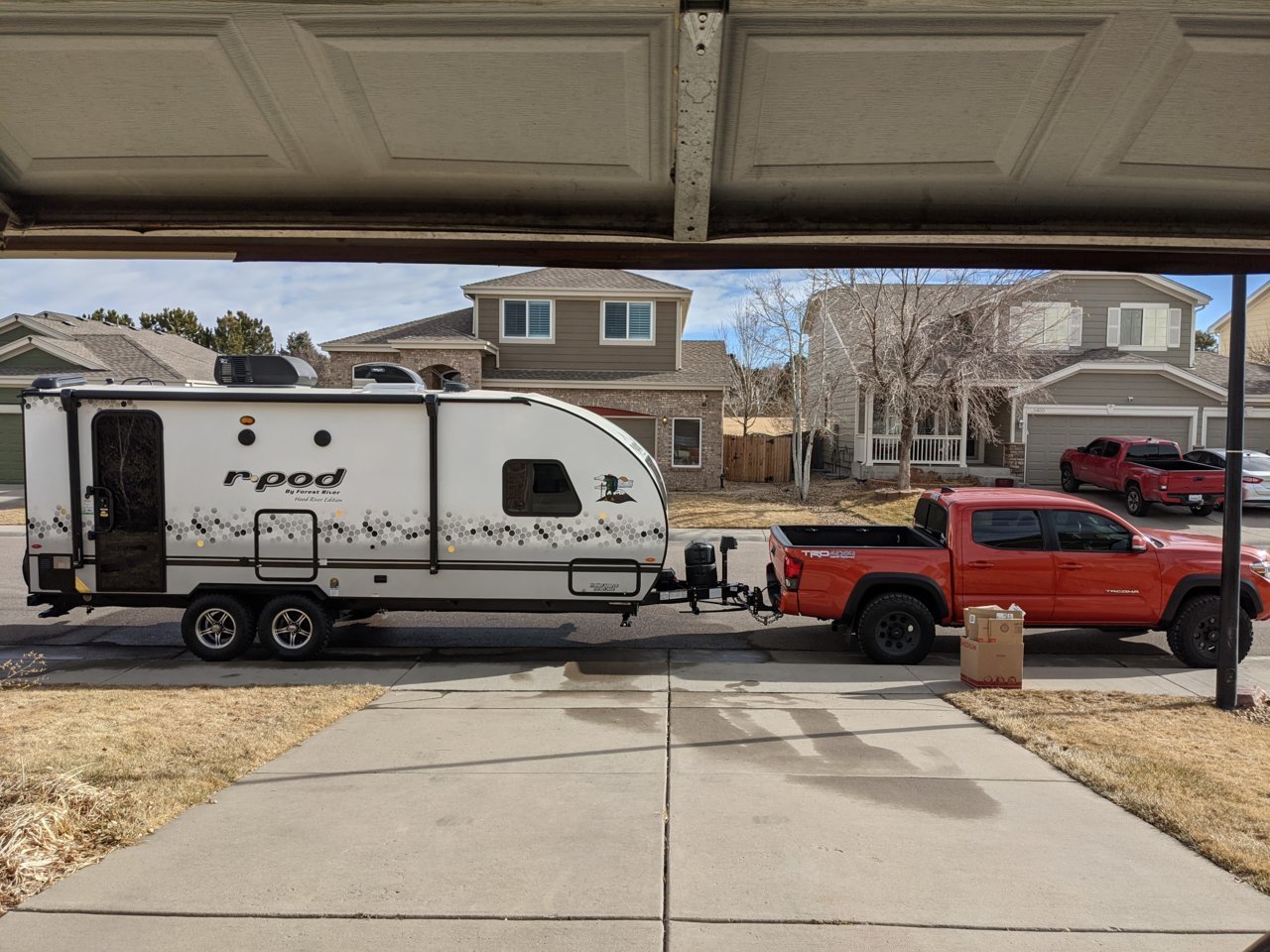

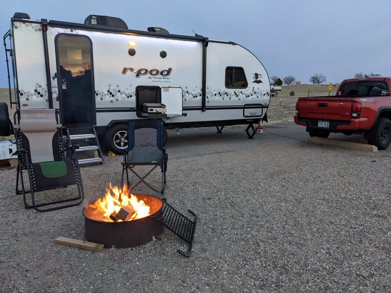

    I just wanted to close the loop on this and thank everyone for the feedback. I ended up getting the R-Pod 202 and it feels like the perfect choice for this Tacoma chassis. Thank you all. For anyone interested, I went with an Equalizer WD hitch and Redarc Tow Pro Elite controller. I get about 11mpg in S4. PXL_20210121_174613334.jpg PXL_20210123_002129122.MP.jpg

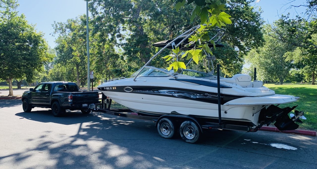

    Big boat/Little truck. 6,000 llbs. Did fine but no big hills. Used 4x4 when pulling up steep boat ramp.
    dropped into 3rd gear to power up on road hills. Then automatic when cruising.

    Michigan
    2017 Black TRD Off Road 4x4, 2019 MGM 4Runner SR5
    Impressive! Tongue weight must have worked out well!

    yes. Long throw on this trailer and twin axle. Didnt even have much bed dip.
    still, wouldn't want to try this to Tahoe. pleasantly surprised how well it worked out.

    Not often. Boat is kept in wet slip, so just for maintenance usually.
    My buddy just towed his smaller boat (probably 4000lbs) from Colorado to Calif. Same truck. Zero issues but he did have to keep it is 3/4 gear the whole way.
