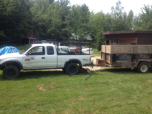

    If I can do this semi-regularly:
    ..then you shouldn't have a problem.

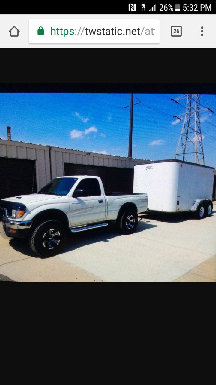

    I run a 20 foot enclosed trailer, 5 speed v6 reg cab no less with double axle and electric brakes with controller. i have helper springs.
    Works just fine but the ride is rough.
    With a load and electric brakes you have full control of all your stops, Im sure part of the loading rating is that the stock tacoma brakes are not the best to begin with and forget about adding a heavy trailer. So yes definitely get electric brakes if you can and a double axle is much safer also
    Wind is your biggest enemy when pulling an enclosed trailer.
