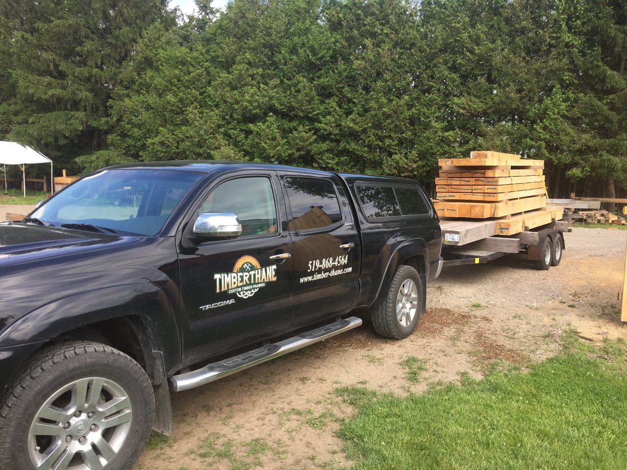

    What is stoping a Tacoma from safety towing 12,000 lbs?

    You didn't answer the question. You just quoted data from manual
    Is it:
    Not enough power?
    Brakes not big enough?
    Suspension too soft?
    Truck too light?

    Thank you. The thing I failed to mention is chassis strength. So in all the factors mentioned, the Tacoma falls short in all of them. The Tacoma is not overrated. How about the new F-150 which weighs only 4200lbs? What makes it able to tow 12000 lbs?

    I asked this question to open a discussion on the differences between trucks and engineering thought.
    As far as laws go, they do not stop anyone from doing anything. Just listen to the news and you'll see I'm right.

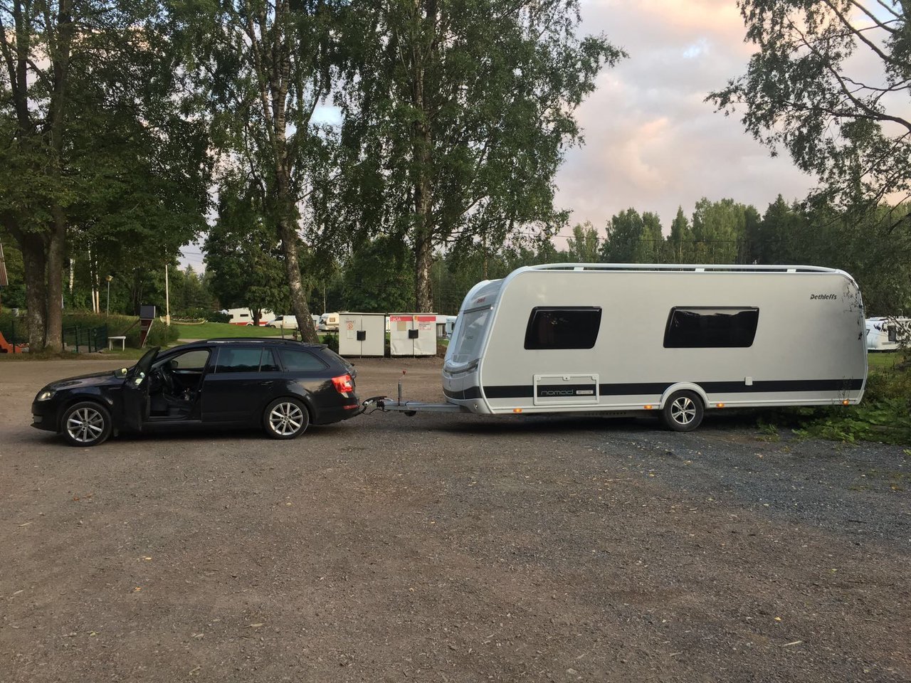

    That’s right, it’s allowed to tow 3500 kg (7700 lbs) with many mid-size pickups/SUVs, but this is also limit for bigger full-size truck like Ford/Chevy/Dodge 2500/3500.
    We don’t have any kind of weight distribution devices, the tongue weight is limited normally to 100 kg (220 lbs). The trailer axle(s) are quite near to the weight center, not as far back like in your trailers. So less weight on the nose.
    I have 2000 kg (4400 lbs) 1-axle caravan trailer (body length 22 ft) which I used to tow with my FJ Cruiser. But it’s ok to tow with Skoda Octavia 2.0TDI too (just at the maximum weight), my friend help to move it when my FJ was ”under construction”:B1A8D08A-2C8A-4723-B331-8A220800A1E8.jpg
