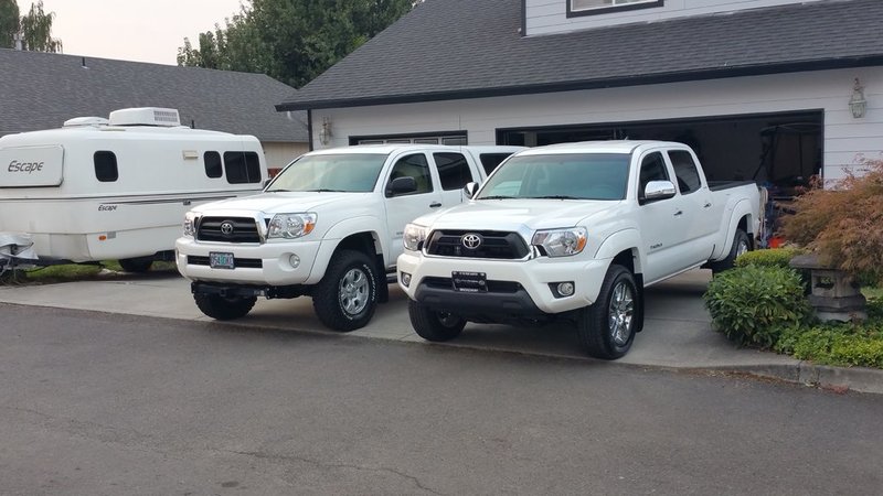

    Look at Escape brand trailer too. I know a lot of people who sold Casitas and Scamps to get one. Mine sleeps 4, shower, toilet, forced air heat, AC, stove and microwave. 3600 lbs loaded with a full tank of fresh water.

    What is the interior height of the Escape? My only issue with the Casita is I'm 6'2" and it is a bit short inside. Nice looking driveway!
