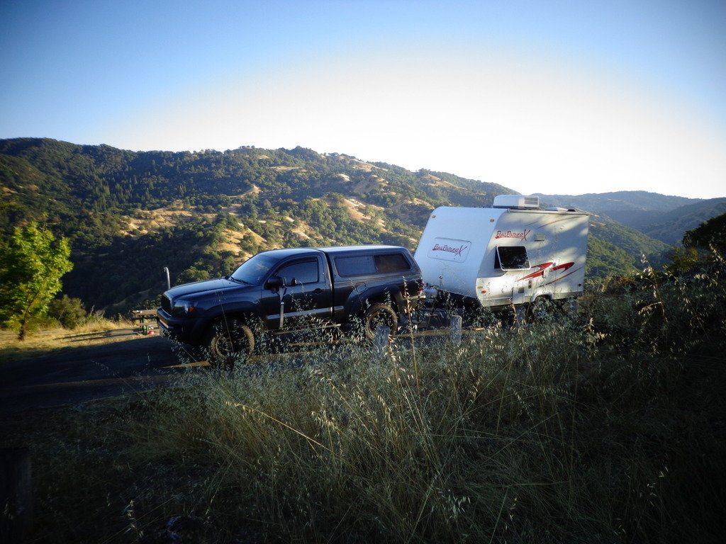

    I tow a trailer with my 4 banger. 2253 dry weight.
    After everything is loaded, I am right below the 3500 limit. Truck does just fine.
    If you want to go fast and not have to downshift going uphill, yeah get a big full size beast.
    If you can drive like a sane person and use your head, you will be fine.
    These trucks are tough. Use it like its meant to be used.

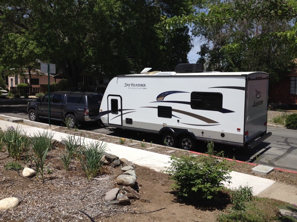

    I average about 10mpg towing (+/- a couple MPG depending on how fast I'm going) and can hold 55mph over Donner Pass.
    Trailer is a 21ft Jayco X213.

    What kind of country will you be traveling ? If flat or mild hills I believe you'll be ok, mountains might not be fun. You're fairly close to a reasonable maximum, allowing for additional weight once loaded. Verify that the weight quoted is real, not just a manufacturer's advertised (advertised doesn't always include items like a/c propane tanks, other options). Also ask about tongue weight.
    Nice looking rig.
