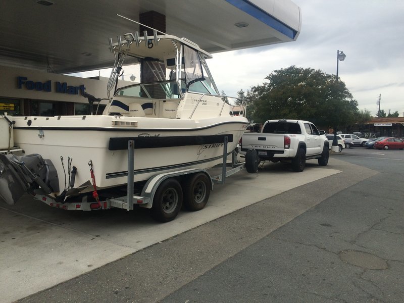

    DoubleTime
    DoubleTime Member
    Dec 26, 2015
    #173156
    21
    Jesse
    2016 DCSB Off road
    image.jpg Boat and trailer with gear is around 5500lbs. Tacoma tows it just fine.
    evansdmax, rcbstuff, Wedge and 3 others like this.
  11. Jun 19, 2016 at 8:42 AM
    #31
    flying_snowman
    flying_snowman [OP] Member
    Jun 17, 2016
    #189881
    17
    2016 Tacoma TRD Sport manual trans
    Thanks for the reply, Looks good.

  13. Jun 19, 2016 at 11:09 AM
    #33
    DoubleTime
    DoubleTime Member
    Dec 26, 2015
    #173156
    21
    Jesse
    2016 DCSB Off road
    Nothing special. I am going to convert the trailer breaks to disc brakes for better stoping. I am very impressed with the towing capability of the truck though.
    flying_snowman[OP] likes this.
