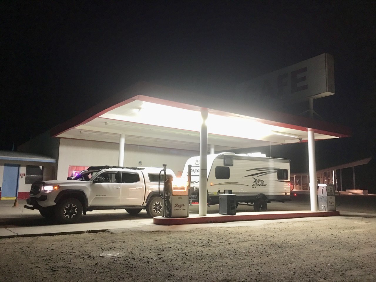

    2017 Tacoma OR 4x4 (formerly a 1998 SR5 PU, 2002 OR 4x4, 1995 4x4 4Runner, 1985 4x4 Toy PU) ... and RIP’s (rust in pieces) to a Bronco II 4x4 & S10 Blazer 4x4
    I just got back from a 800 mile (roundtrip) camping vacation with a 20’ 3000lb Jayco trailer loaded to almost 4000lbs. I added a Single AAL and 5100’s to my 2017 4x4, and it really rode and pulled well, by passing semi trucks and on hills and rough roads. The trailer has a flipped axle and has a high profile, but it was not affected by cross winds either as I have a beefy anti sway/weight distribution hitch on it (Husky CenterLine TS). The back of the truck in this pic was loaded including an extra 15 gals. of gas. Edit: i’ve decided to install Firestone Ride-Rite airbags after my last trip carrying a lot of weight and the trailer.

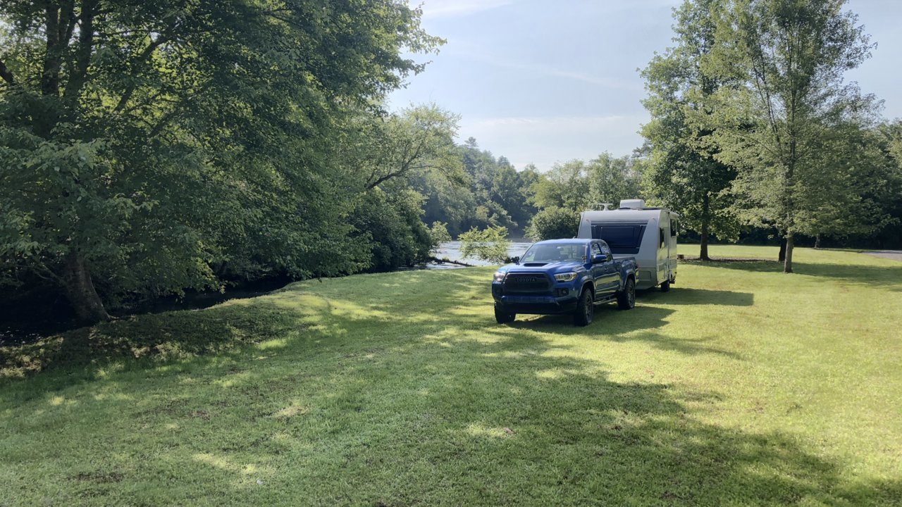

    I pull this 2018 Lance 1575 single axle using a WD hitch and sway bars with no issues. I use a Tekonsha trailer brake controller and it's really smooth stop-and-go. The trailer is only 3200lbs loaded with water and propane. Have to run with ECT in 4th gear on the highway most of the time if the terrain is slightly hilly, and getting to my land on the Nottely river in NC is definitely so.
