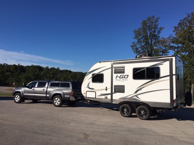

    First welcome aboard:hattip:. You will get as many opinions about towing as there are folks towing. I knew when I bought my truck I would buy a camper that the truck could handle. I read the Tacoma towing bible and was able to set up my truck as best I could for the type of towing we will/have done. My camper is about 4200lbs ready to camp with no water in it. I wanted dual axles for more stability when towing and the additional set of brakes for stopping power. Things you may want to consider are; a larger transmission cooler and a way to monitor transmission temperatures. I bought a scanguage II to monitor my transmission temps. Never tow in 5th gear, put it in 4th gear to reduce gear hunting and heat generation. Some type of rear suspension upgrade i.e. airbags, sumo springs or other helper springs. You will need a brake controller for the trailer brakes. I bought the Prodigy 3 and really like it. A weight distribution Hitch is a must when towing to help prevent sway especially when trucks pass you or hi winds. I bought replacement mirrors which are plug and play - no mods required.
