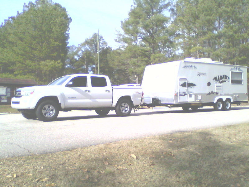

    Here's a pix of what I have been towing since 2008. Dry weight 4200 lbs. I have a WD hitch (no sway control), brake controller, factory tow pkg plus additional trans cooler, Ultragauge to monitor pan and torque converter temps, and clip on side mirrors. Since this picture was taken I have added Sumo springs to keep it level.
    Like others have said, it is no fun towing. I keep it around 60 mph, usually in D, but will go into 4 if temps start to get around 200F. I get 14 mpg on the flat in D, average 12.5. Biggest challenge is the gust of cross wind when a semi blows by at 75. Just take it slow and you will have no problem.1701-111019.jpg
