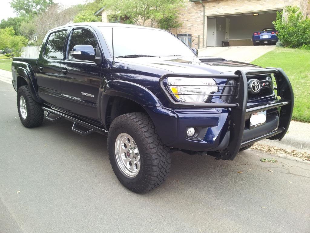

  11. Apr 18, 2013 at 12:45 PM
    Primo 95
    Primo 95 Well-Known Member
    Jun 23, 2012
    #81207
    911
    Primo!
    San Antonio, TX
    2012 DCSB 4X4
    265/75/16 S/T Maxx 16X8.5 Level 8 Trackers 5100 1.75 HID, LED interior, 3" N-Fab step bars
