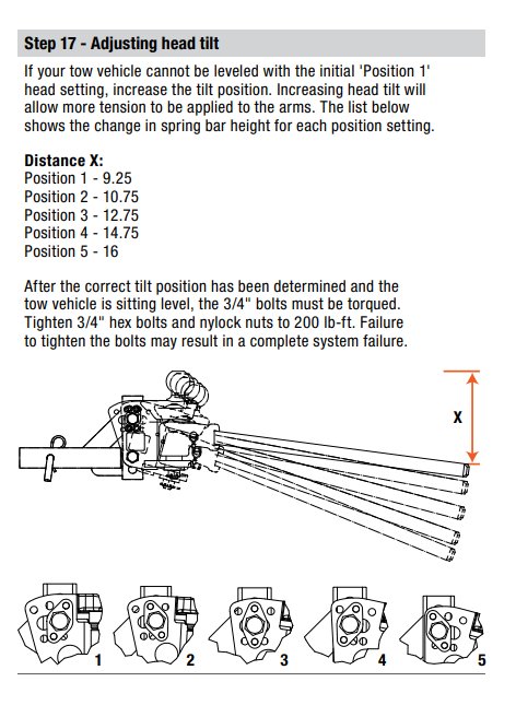

    Unless it's my eyes, in the video at approx 2:06, can someone explain the reason for the angle of that ball hitch mount piece attached to the ballmount? I get that the piece appears to provide the option of adjusting the ball height up and down by removing a couple of bolts rather than carrying or needing different drawbars, but why the angle? It doesn't appear to be adjustable. It's the first time I have ever seen this: normally the ball is pointing straight up, at least with my truck and my son's who tows a heavy boat and enclosed snowmobile trailer with his F150.

    edit: Oh you're talking about the video, it's likely for the same reason I've explained below.
    If you're talking about the picture of my Tundra above, you would be correct that it's angled a wee bit. This is all part of the setup and is how this particular hitch is designed. This is what I was referencing above when I said "properly set up hitch" because I went through every option to find what worked best. I believe I landed on position 4, maybe position 3.
    The hitch - https://www.curtmfg.com/part/17500
    The instructions - https://assets.curtmfg.com/masterlibrary/17500/installsheet/17500_INS.pdf

    Sorry for the confusion: Yes: Thank you! I noticed it on your Tundra as well, but I just edited my post to indeed clarify was speaking about the video with the Chevy view at approx, 2:06. Now I understand the setup: pretty slick! As an aside: I'm thinking/assuming those 2 (?) 3/4" bolts that tie it all together must be grade 8 or better? Or at least the same strength/hardness as a high quality hitch pin? They both perform a critical function to say the least. I noted the torque spec for those bolts. Yikes! :eek: Thanks again!

    the angle is what distributes the weight towards the front of the tow vehicle...
    the more angle the more the load bars or chains will transfer to the steering axle of the vehicle.. i know there are good videos of how they operate but i can't quickly find one right now..
