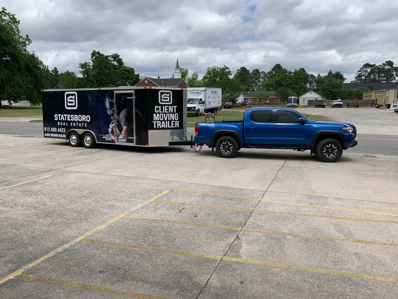

  14. May 27, 2019 at 2:09 PM
    #54
    Taco1701
    Taco1701 Well-Known Member
    Jan 30, 2014
    #121871
    850
    William
    GA
    2020 DCSB TRD Sport 4x4 Cement
    This trailer was 22ft and right at 3400lbs empty and we had it packed full of furniture. Not sure what the final weight was, but it was heavy. The truck did very well getting up to speed and stopping. It was the wind that made it more difficult. You felt every crosswind and while it never felt unsafe, it was more trouble than I would want to deal with on a regular basis. Every now and then is no problem, so it depends on how often you want to use the travel trailer.
    Also, I’m in south GA, so pretty flat. I wouldn’t want to tow that in the mountains. The truck could do it, but it probably won’t be much fun.

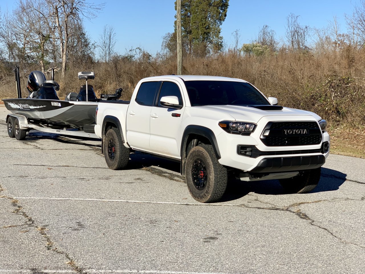

  16. May 28, 2019 at 9:59 AM
    #56
    Bowhuntercoop
    Bowhuntercoop Well-Known Member
    Jul 16, 2013
    #108357
    1,841
    2025 gx550 overtrail. 2025 limited off-road tundra.
    Mine tows great, better then my 2nd gen. Have zero complaints pulling the boat up and down the east coast. A5888641-CA2A-42EB-90B0-877BCB6DE576.jpg
    vicali and Greg.Brakes.Tacos like this.
  17. May 28, 2019 at 10:08 AM
    #57
    Undertow
    Undertow Well-Known Member
    Sep 19, 2017
    #230450
    562
    CT
    2020 Cement DC OR 6MT
    Stock
    What size Pro Comp Rockwell wheels are those? They look like 20's??
  18. May 28, 2019 at 10:12 AM
    #58
    Greg.Brakes.Tacos
    Greg.Brakes.Tacos Don't Feed the Animals
    May 24, 2018
    #254446
    3,703
    Greg
    Between Richmond and Virginia Beach
    2017 Taco DCSB TRD off road
    wanna be mods
    These are for sale, by the way, and they are Series 44 20x9 -12 offset and 4.5 backspace and are wrapped in pro comp at sport 275/60.
