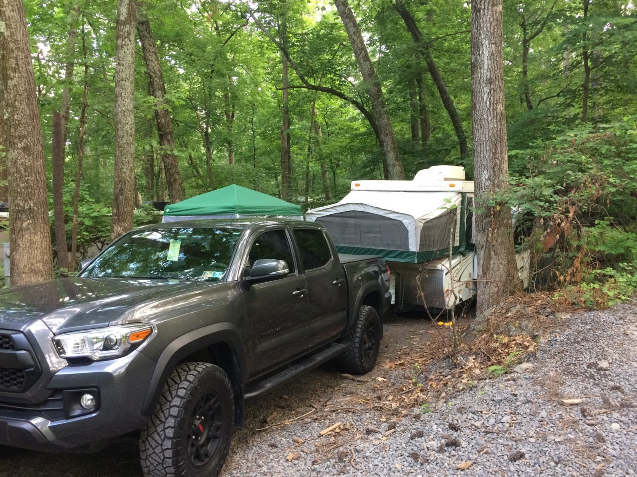

    I tow a Starcraft Centennial 3606 that's 3200lb empty. With gear in the bed and some additional camping supplies in the trailer, i'm probably at 3500-3600 lbs total plus 4 adults and 2 kids. I definitely feel it back there, but I use 4th gear with ECT on and keep it under 60 mph. It's noisy and shifts a lot, especially on hills, but I've had 0 problems. No overheating, no swaying, nothing. I also use the Takonsha P3 brake controller. I will say that with the Offroad model, it porpoises more than I would like due to the shocks (I assume), so I added a weight distribution hitch and honestly I don't think it's made a difference. Would love to get something bigger/heavier, but feel comfortable with this weight/size right now.
    cshrum and Eluv201 like this.

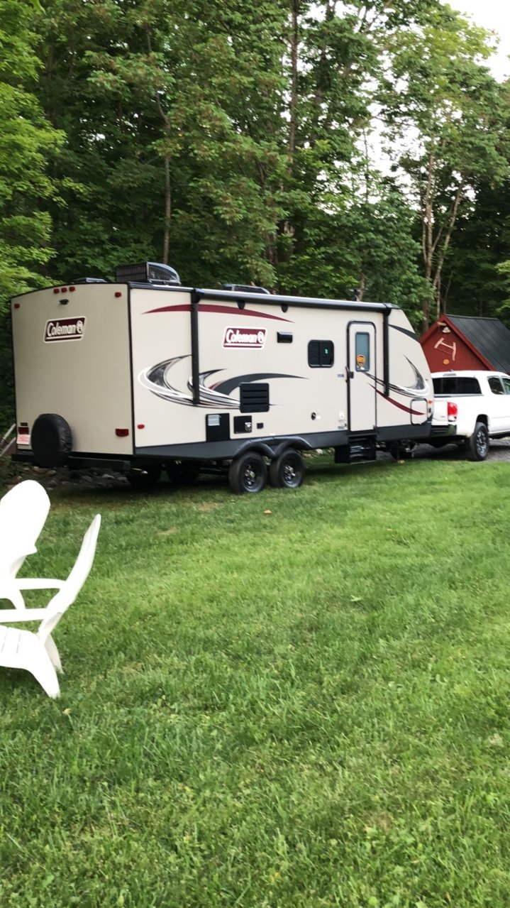

    I just wanted to give my 2 cents on this as I have done a bit of towing previously. I own a 2016 Tacoma SR5 now and about a month ago we bought a 21 foot Coleman travel trailer. It had a claimed dry weight of 4500# and I knew that would be a max on the comfort towing zone for the Tacoma but I figured i could easily get another truck easier than a new camper, if it was terrible. I still have the Tacoma after a few trips, one being a trip into the Berkshire mountains in western mass. I’m towing this camper loaded at around 5200# that includes passenger weight in the truck, etc. I have found that ECT power is almost useless for really helping the truck. I use it but I really rely on the sport shift to eliminate gear hunting and using the engine braking going down hills. I have a scan guage to monitor trans temps and haven’t seen anything over 213 and that was a mile and a half long steep grade from a dead stop. I also have tekonsha break controller, a weight distribution hitch and I got timbrens to help the sag and porpoising. All and all I am very impressed with this truck overall. You just need to be very aware when towing with it and help it along.

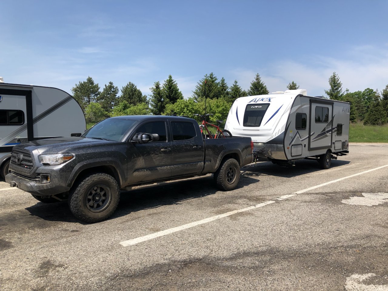

    We’re pulling a Apex Nano 193, which weighs somewhere around 4,500lbs when loaded. It tows great unless we’re into a headwind...then it revs high often, which is annoying. MPG sucks, but I know friends that tow with a Silverado 2500 and get the same 8.5mpg that I do (bigger trailer of course) - it’s all dependent on what you’re towing. Picked up a Scangauge II per Daryl’s suggestion and am starting to watch trans temps. Might add a secondary trans cooler, but we’ll see how it does next weekend first.
    Saltypickle and joestacos like this.
