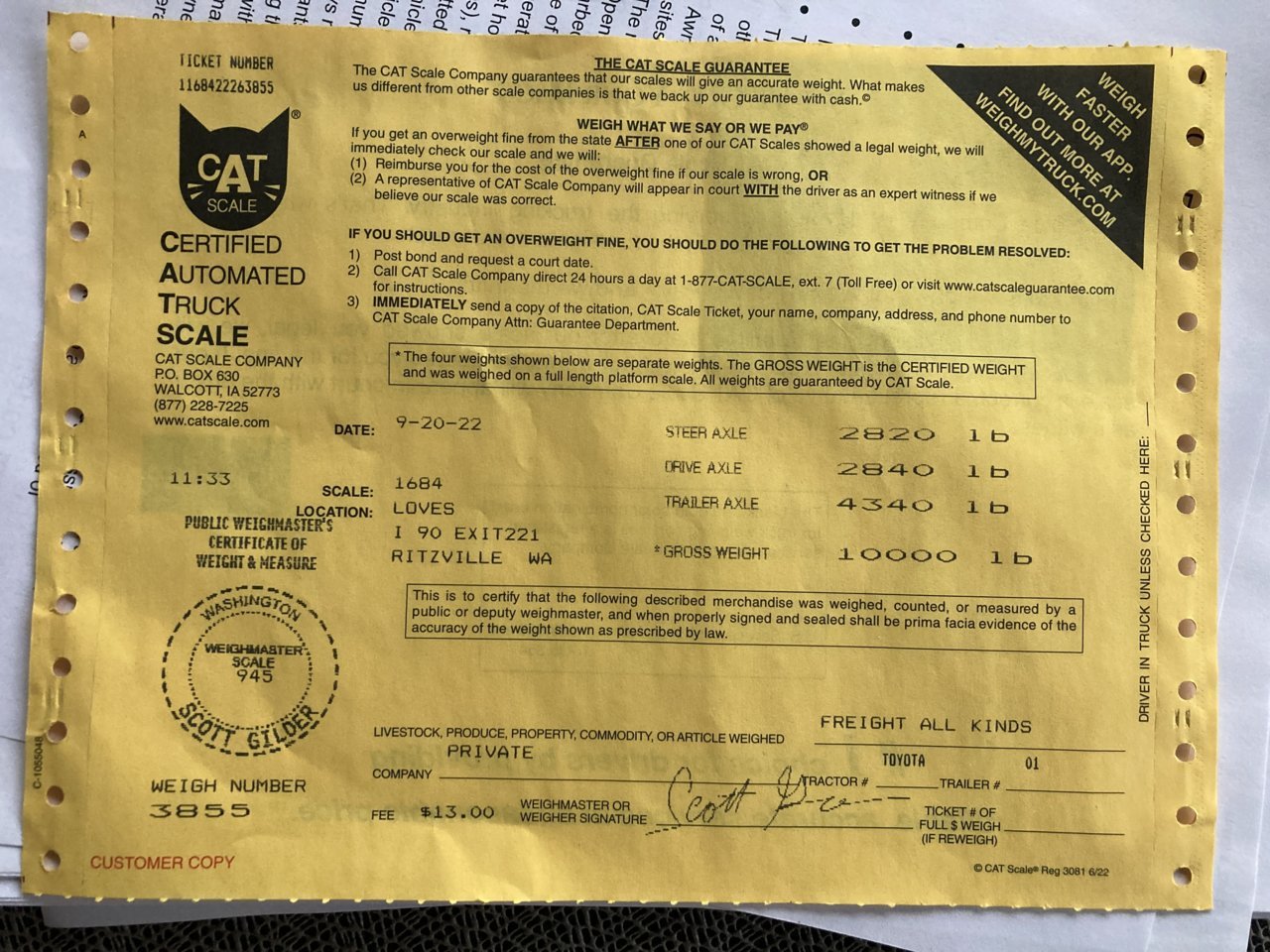

    Tongue weight & trailer weight are totally separate. Tongue weight gets subtracted from your tow vehicle's payload & is not supported by your trailer axle(s). The point of a WDH is to distribute tongue weight to both tow vehicle axles opposed to rear only. It looks like they measured Tacoma 1)front axle 2)rear axle & then 3)dual trailer axle together. Tacomas have approx. GCWR of 11,200 lbs so @vicali is in the green.

    Yep, I was trying to get my overall GCWR on this trip. I could've either unhooked and weighed the Tacoma alone, or figured out how to measure the tongue on the scale.
    I consciously load things in the trailer and keep the back of the Tacoma empty, max is our pup and crate ~80lbs in the box.

    I’m following all that. I was trying to determine if the weight reported for the trailer is accurate or not. If tongue weight is 500 lbs, that’s included in the truck rather than accounted for in trailer weight reported by the ‘third’ axle.

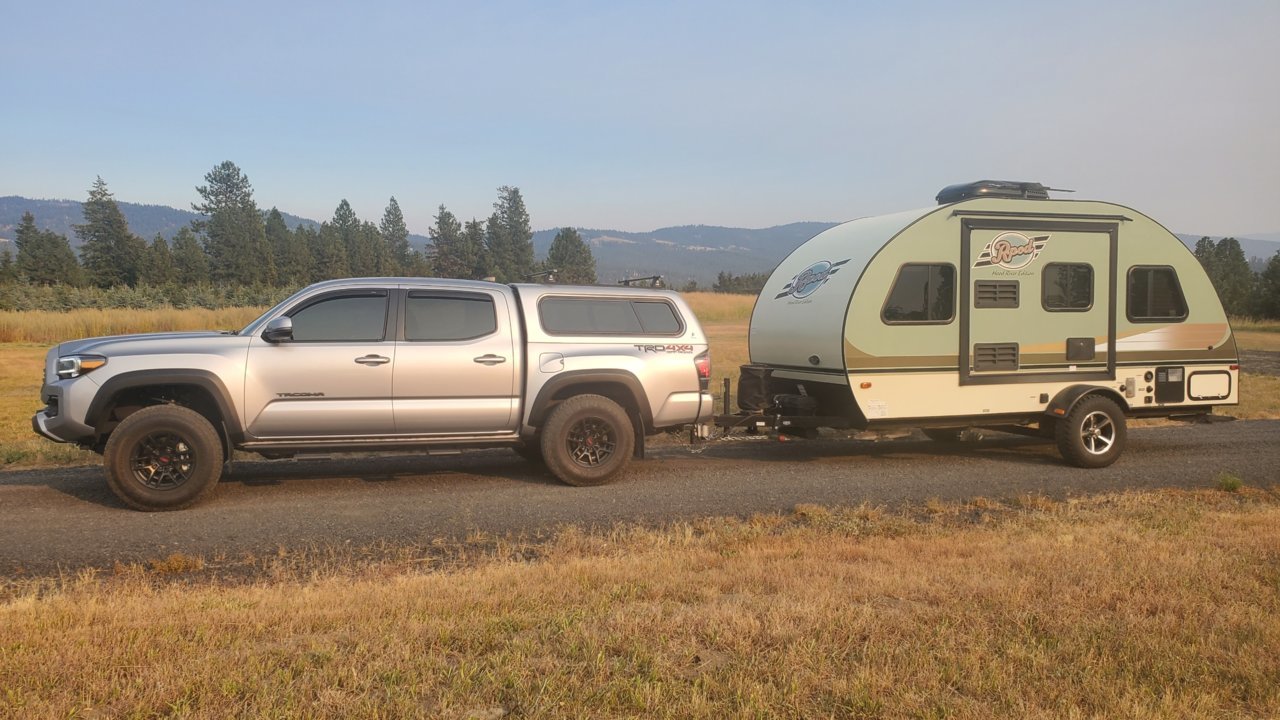

    I have a rpod dry weight is 2400lbs. I added a Alcan spring pack and redarc tow pro elite. Lew at Alcan was great working with me to get my needs met and getting my truck better set up to tow safely. I had previously leveled my truck with Bilsteins. Taking the rake out of my truck meant when I hooked up the trailer even being well under max towing capacity meant my truck was squatting pretty bad. Taking that weight off the steer tires meant the truck did not feel great towing even with a WDH. It has been a night and day difference with the new leaf pack. I also did a kdmaxx tune about a year ago and recently upgraded to the newest variation. The tune really helps with the gear hunting and my mpg when I tow I average around 15.3 depending on the terrain. My Tacoma will never tow like a full size but I never expected it to. I think as long as you set your truck up properly, keep your trailer weight well under the max weights posted for our trucks they will do an adequate job. Resized_20220902_171427(1).jpg
    My truck before it was set up properly unfortunately I don't have any since the new leaf pack.
