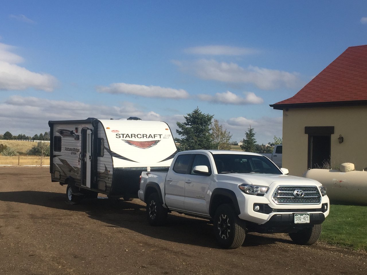

    I live in northern Colorado and frequently tow a 17 foot travel trailer over The Rockies to Utah. Trailer weighs around 3500lbs with gear. Truck gets about 8mpg over the pass and about 15 when the road flattens out. Runs at 3500-4500 rpms 65-75mph. Definitely screams up steep grades but does really well on the flats. Wouldn’t recommend towing more than 3500-4000lbs.

    Truck can pull more comfortably. 3500 is barely the max you can pull with a 4cyl or without a tow package.

    Just voicing some real word experience. I wouldn’t recommend towing up a 5-7% grade on a regular basis with more than about 3500-4000lbs. Unless you like low speed and high rpms.

    And braking is an issue at that weight... The Taco isn't stellar in that regard.

    With a brake controller and trailer brakes I honestly have no issue slowing down. The real issue is power and incline. If you’re towing on flat roads it’ll do more than 4000lbs no problem.
