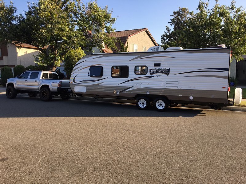

    My truck doesn't have a Trans Oil Cooler either.
    I have a 2013 4x4 double cab Off-Road manual transmission (35" tires and Geared 4.56). My trailer is a 27' x-lite travel trailer that weighs 4,750 lbs dry. I've taken the trailer up and down the California Coast and all the way to Utah. It struggles going up mountains, sometimes having to shift from 5th (I hardly in 6th gear when towing.) to 3rd gear. The rear end sagged with my stock leafs combined with my AALs.
    Once I changed out my stock leafs for Alcan Leaf Springs, my truck hardly sags. I recently added a Magnuson Supercharger but I have not taken the trailer anywhere yet.
