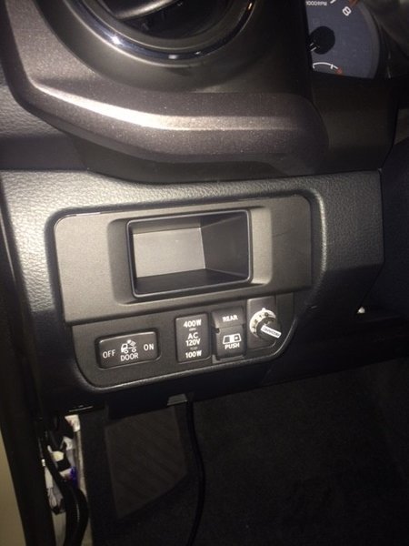

    I put my brake controller in the jpg attached. It is a redarc elite controller. After it is calibrated, it proportionally brakes as much as your vehicle brakes if its in Auto mode. You can put it in manual mode and have full control of the trailer brakes as well. The harder you brake, the more red the LED gets. It is a pretty neat system. You do have to be handy with a dremel if you want to mount in this location but youll only need to dremel the blank switch plate and nothing else.
    I do, I actually feel the rear is raised a tad higher. I believe most people say it raises the rear end 5/8" and it does feel stiffer in the back for sure unloaded.
    Got it. I believe the manual comes with a 4.3 and the auto comes with a 3.9 so I would of assumed it would of been better for towing gearing wise. But you are correct, we cant compare apples to apples here.
