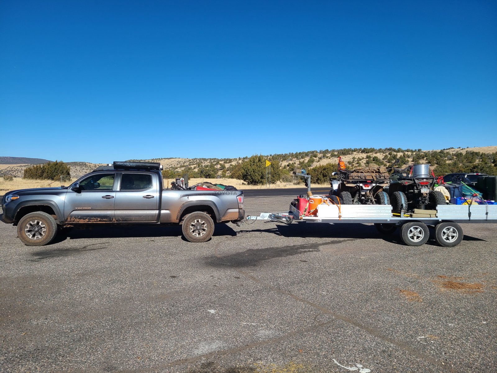

    Cushmaat
    Cushmaat Well-known wiseass.
    Sep 13, 2014
    #138213
    658
    SE AZ
    2022 TRD OR 4x4 DCLB MGM
    13 - 14 mpg at 6,000 to 7,000 ft. In Northern AZ.

    Nice flat bed. What make/model is that? Empty weight, max weight, etc? TIA
