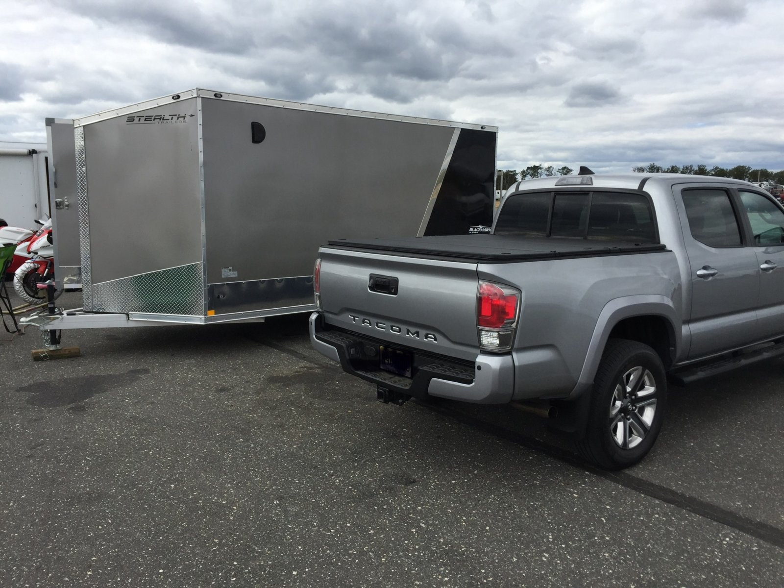

    Tows my 7x14 dual axle all-alum toy hauler with 2 track bikes and accompanying stuff OK - not great, or even very good, but still doable. Even with an OVTune, it's just 'OK'.
    Sure, more power, better breaks and better fuel economy would be really nice, but it fits in the garage and for all my other needs, it's perfectly fine and overall, I really enjoy the vehicle.
    Canadian Caber likes this.
