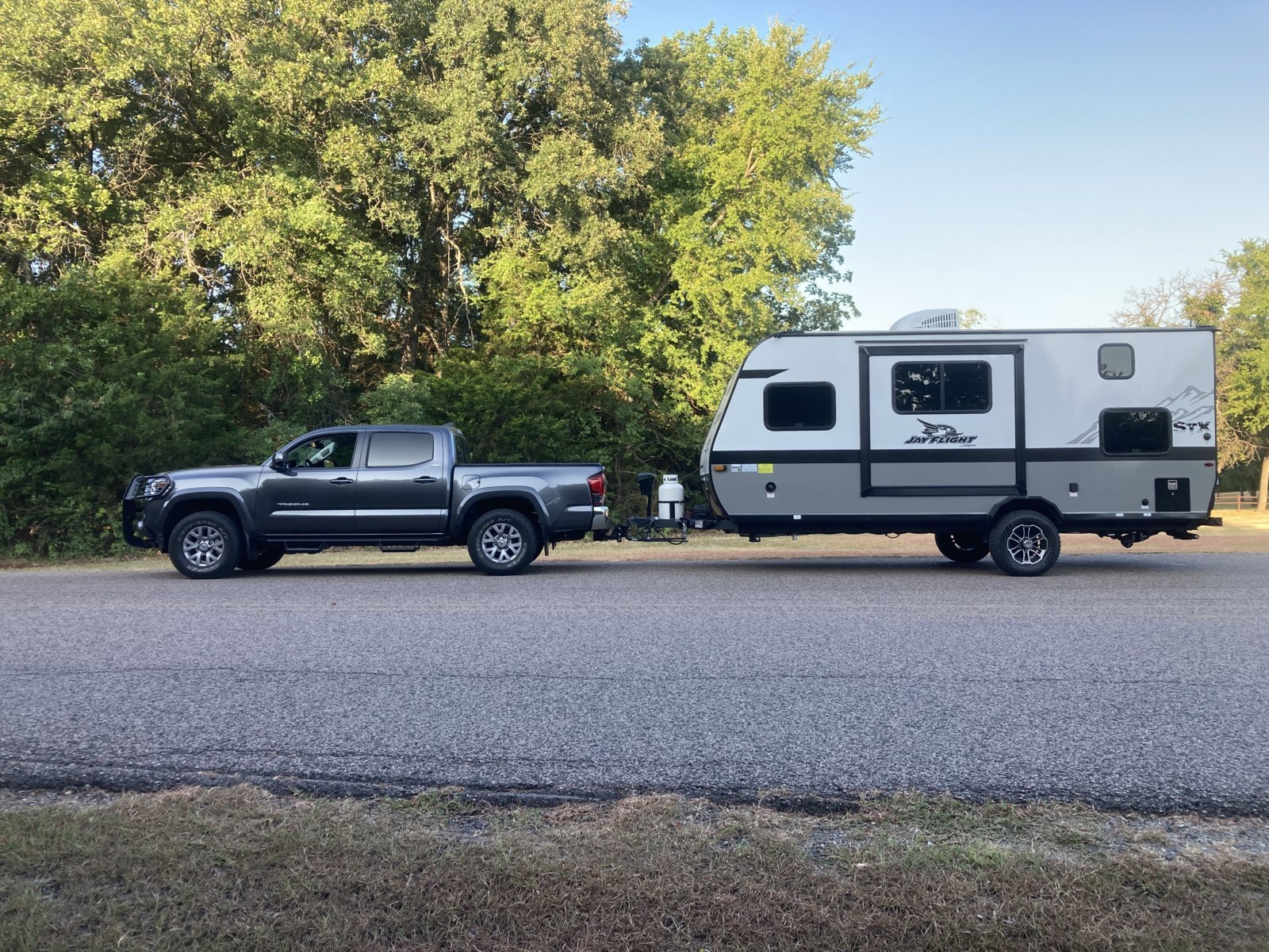

    I tow with mine frequently and have no complaints. Totally stock setup except for brake controller.IMG_0834.jpg

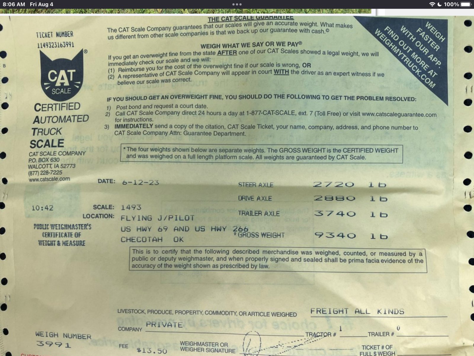

    Our camper is 3800# dry. It’s only 7’ wide instead of 7 1/2 or 8’ which causes less drag and I didn’t need mirror extensions. I weighed it with it fully loaded (not water tank) with all our gear including the bicycles on the front A-frame of the camper. We were well within the max towing rate but we were at max axle weight. 1000 mile road trip average gas mileage was about 10.5. It’s not a Cummins or a Power Stroke but it will do the job, you just need to be patient and let it rev in S4.IMG_1311.png

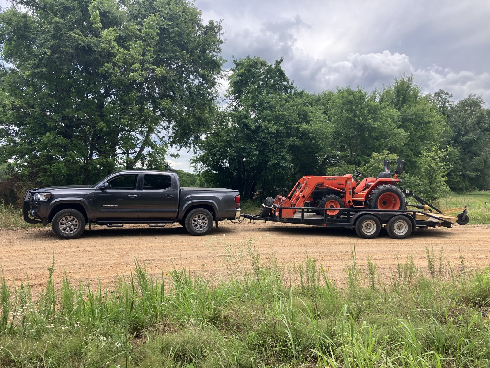

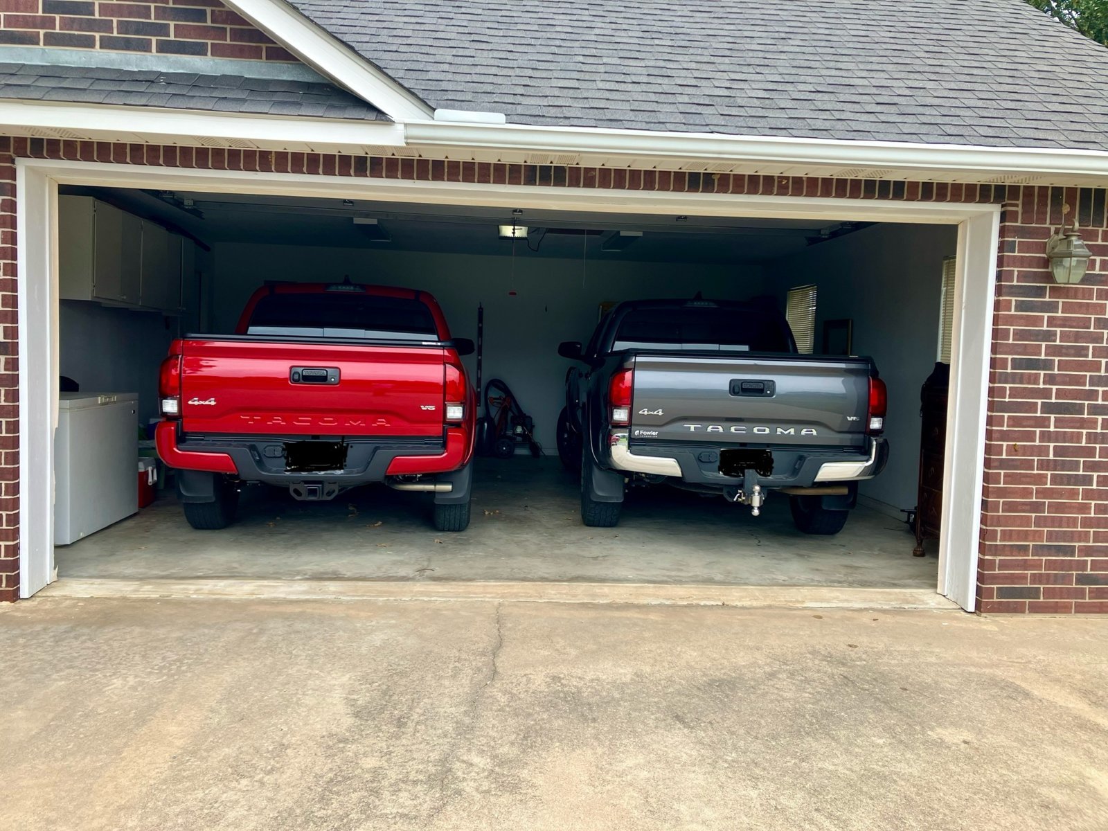

    I like the tacoma for around town stuff...way easier to park than a full size. I use it for light truck stuff...towing the jet ski or the boat, hauling less than 1000lbs or so. I have an older 3/4 ton GM for when I need a real truck....it spends most of it's time sitting...I might drive it a few times a month.
    Nothing is gonna check all the boxes. Just get 2 trucks.

    Hers is basically a garage queen LOL
