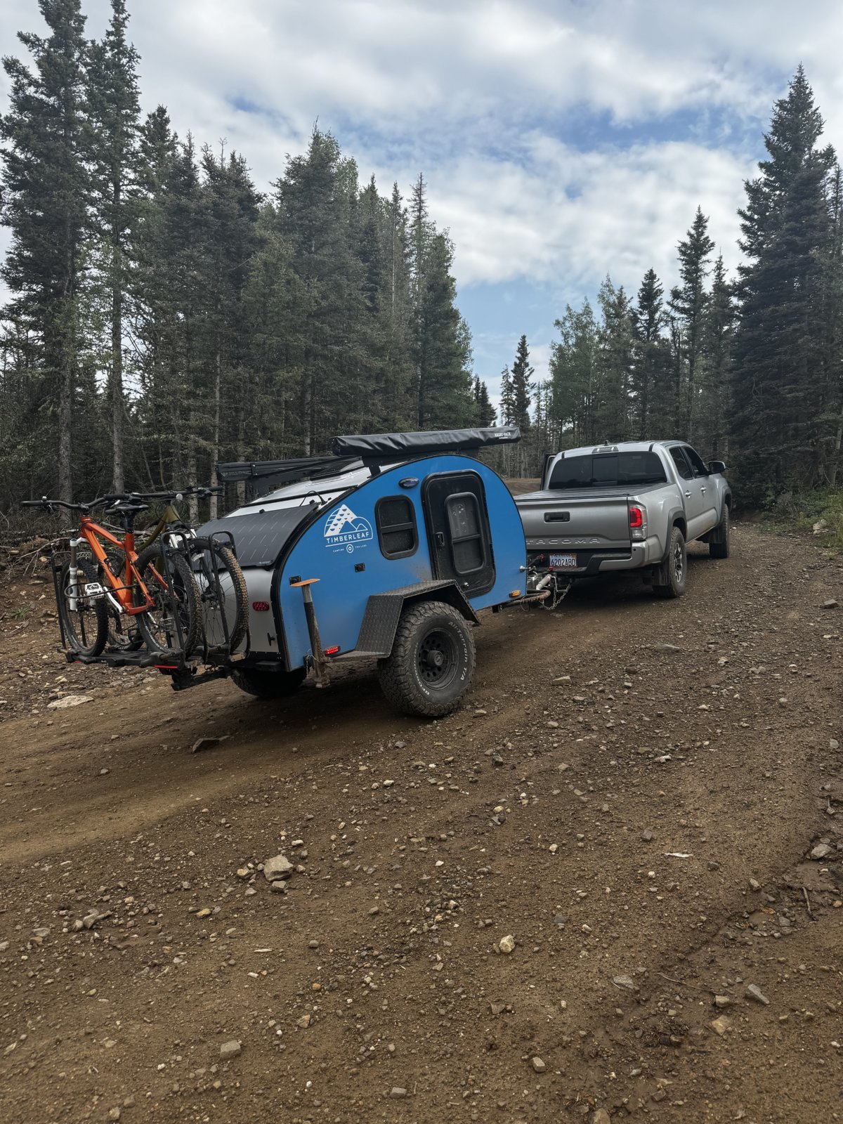

    Just finished a 2000 mile roadtrip to NM and SW Colorado with my timberleaf pika (1800lb) teardrop. Did some light offroad stuff to find dispersed sites. All good. Even on the interstate 6th gear is not useable unless flat or downhill. Just can’t do it. 3000-3200 RPM in 5th is what it takes to get uphill. Sometimes 4th or even 3rd is necessary to keep highway speed. All in all very happy though.

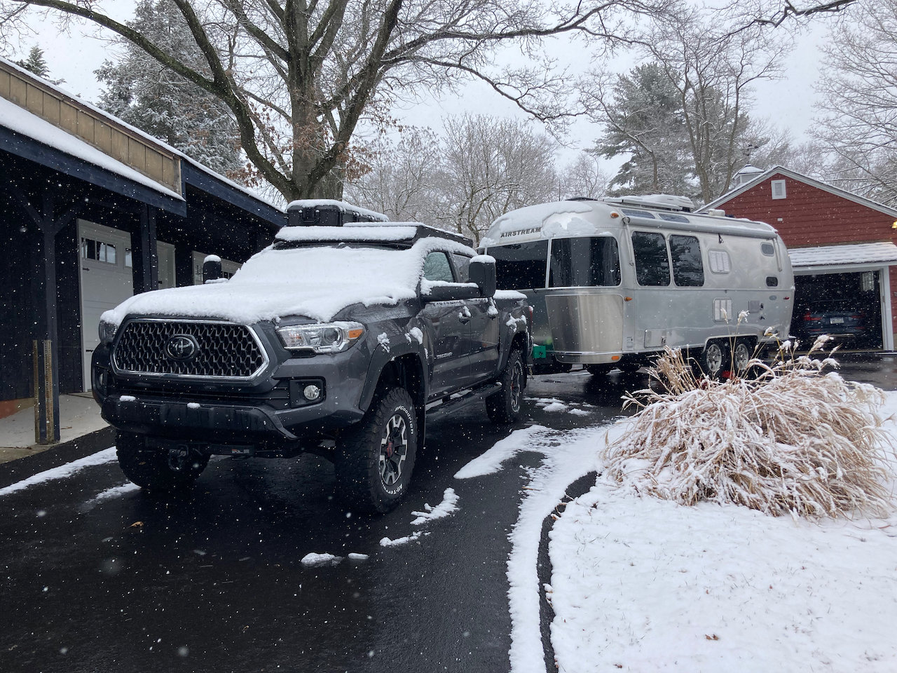

    2018 TRD OR MT + 23’ Airstream Flying Cloud ~6000lbs - >30,000 miles towed - coast to coast, NY to FL multiple times - crossed Sierra Nevadas, Poconos, Rockies, Blue Ridge, Bitterroot, Cascades - multiple >15% grades - perfectly capable - have video pulling trailer at 80 on Bonneville salt flats. Upgrades that make this work:
    1. KDMax Tune
    2. OME HD shocks/spring/UCA kit
    3. 2-wheel low hack
    Only reason I would upgrade would be to pull a bigger trailer - then I would be tossing up a Tundra Pro with an F150 3.5 … Don’t particularly want either.

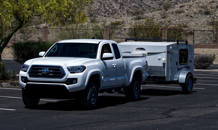

    My smaller camper probably comes in at 1200 pounds. But I do load the bed of the truck with other gear and the inside rear cab
    carries stuff too. I found running in ECT and 4th was the best response and was totally surprised on inclines that I had to drop to
    3rd and scream at 3000+ RPMs just to maintain 40-50 mph. Now these inclines out here in Arizona ( north of Phoenix 'round Bumble Bee and beyond)
    are pretty stiff, coupled with 190,000 degrees it can take a toll so I don't push it. Still I'd like to think I could run with no issues in 4th
    but can't.
