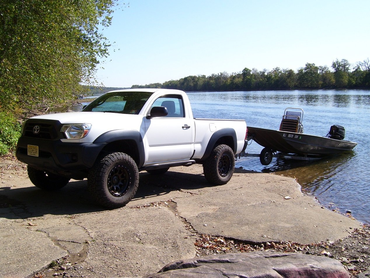

    I tow my 16' with 33" tires and it's fine. The 13' boat with the 350 Chevy weighed more but it still pulled ok. Hills will slow you down so if you see one ahead, try to get a running start for some momentum to help.
