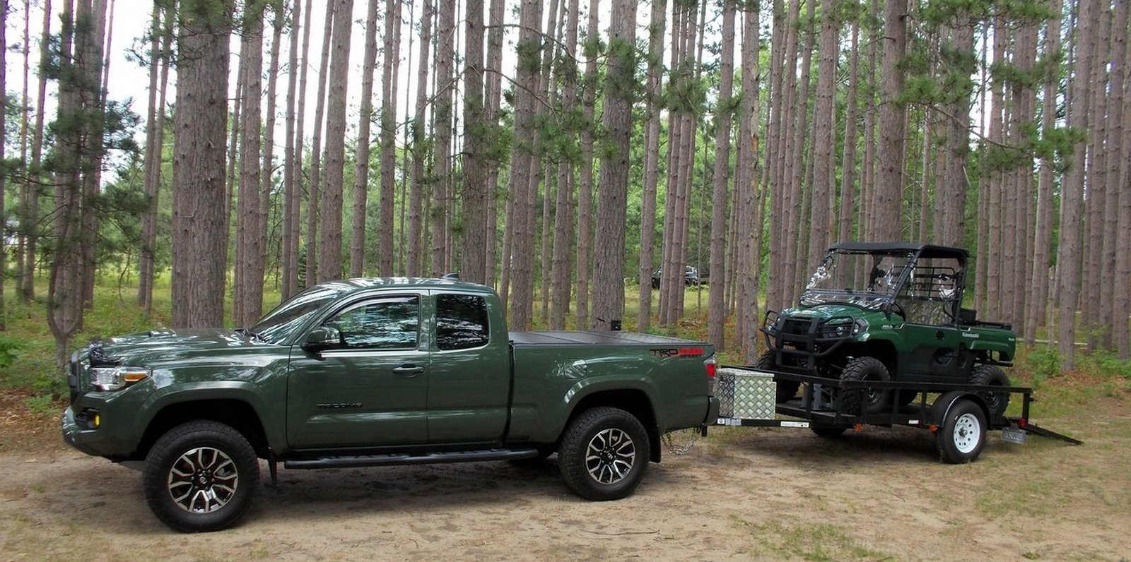

  20. Oct 13, 2023 at 6:01 PM
    #40
    Pwakchop
    Pwakchop Well-Known Member
    Sep 20, 2021
    #377551
    539
    Nate
    Georgia
    2021 Cement DCSB TRD Sport
    Whole lotta' momentum
    Sorry to derail, but beautiful truck man! Love the sport wheels, definitely the best wheel design yet. Can't get rid of mine because I simply like them too much! What tires are those? Look like terra grapps to me! Have a good one!
    specter208 and Irons[QUOTED] like this.
