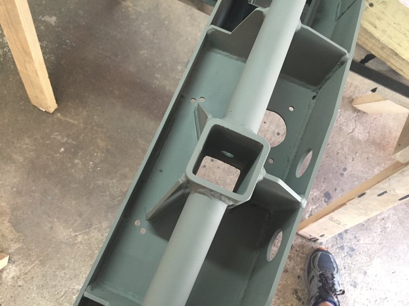

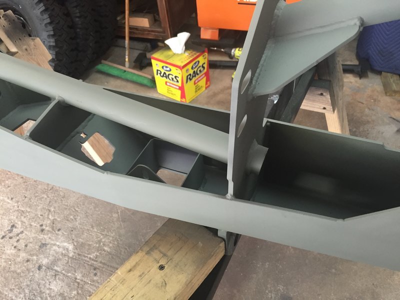

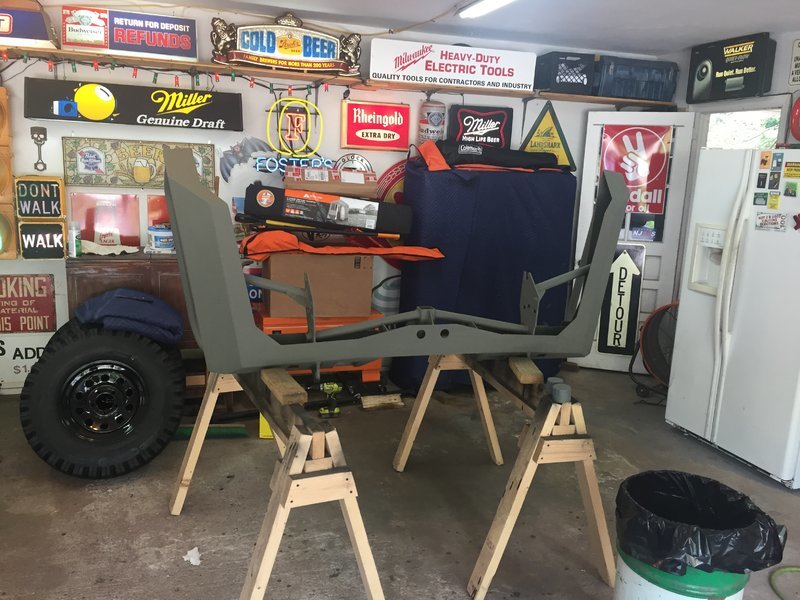

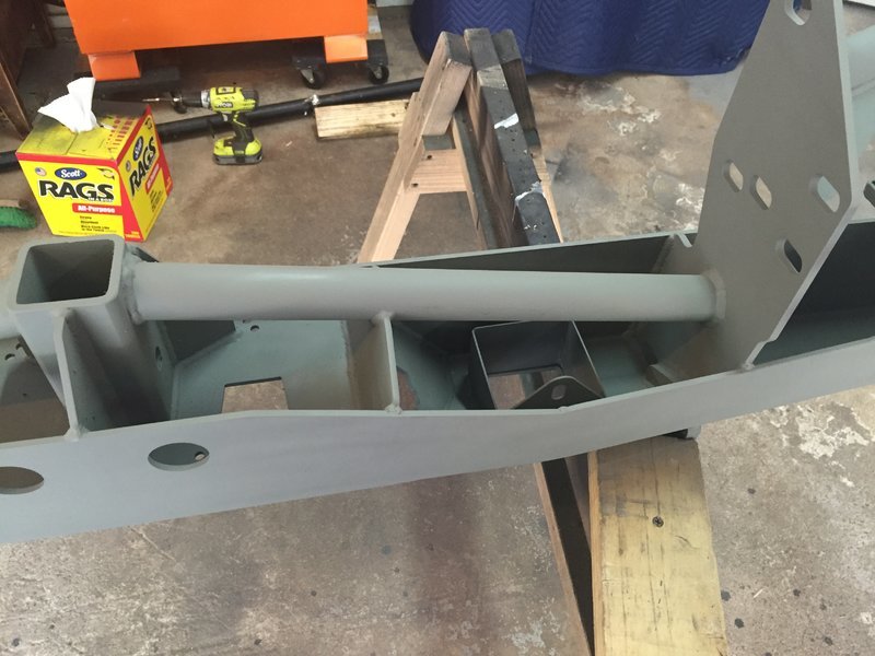

    :thumbsup:I've towed 7,000 lbs more than once with my Bruteforce bumper. Nothing to worry about.
    @Bruteforce Fab
    Triple, fully welded, gussets at the mounting point
    Steel tube with plate center support running across to frame plates
    Cross tube through the frame plates not just butt welded.

    That's some serious beef. Thanks for the pics!

    No prob. You can try to explain how beefy these bumpers are all day. The pics are irrefutable though :thumbsup:
