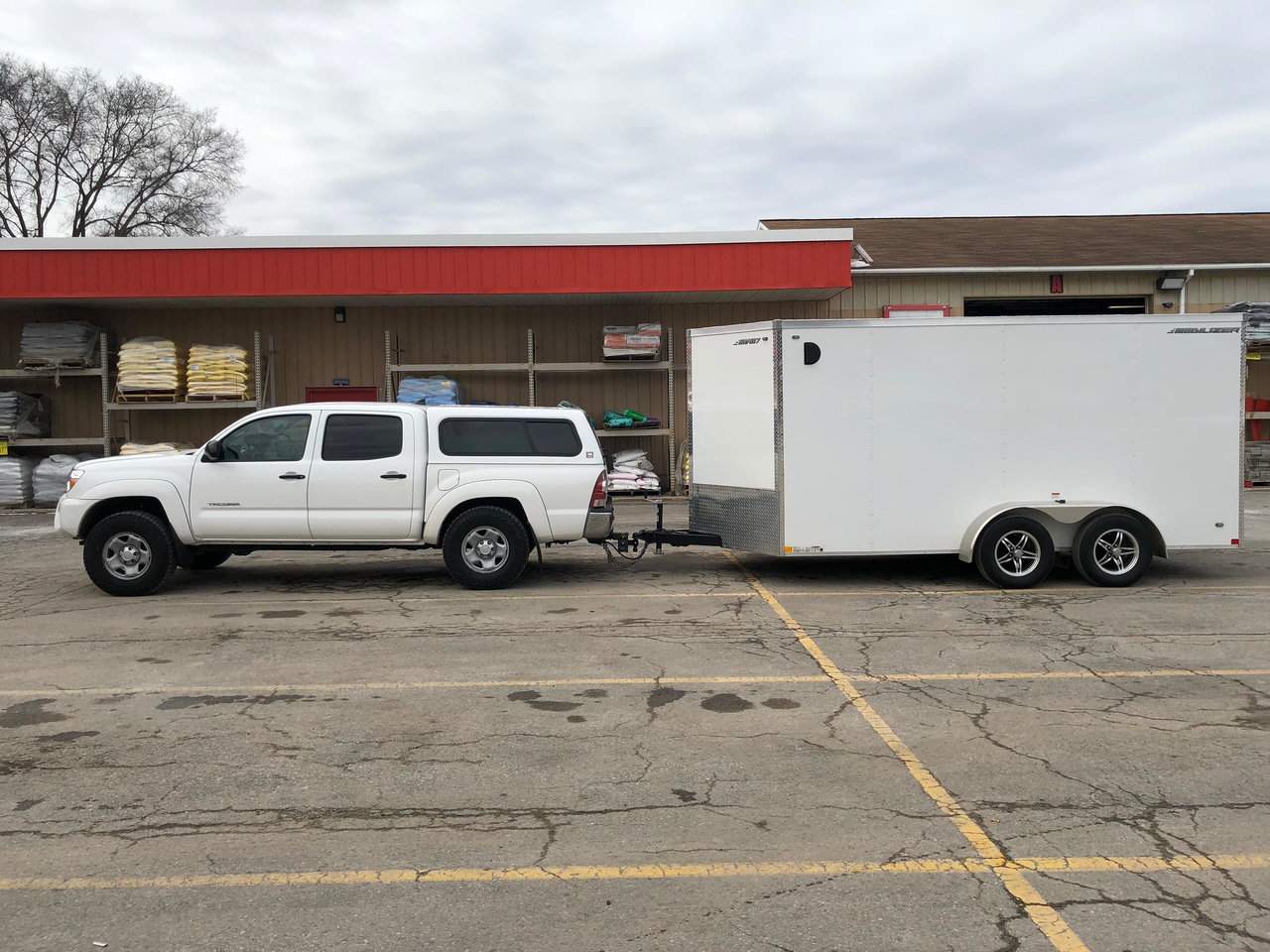

    Hey y'all, curious to hear from those who have towed close to the GCVWR in their 2nd gen. I installed the Wheelers Offroad 5 leaf HD springs, thinking I would be towing max 4,000lbs. I was all packed up and ready to move from Michigan to California but I noticed I had a lot more sag than I had anticipated. Lets just say I was a bit off on guessing the weight of my toolbox/tools/other stuff. I found a scale after some searching and my 7x14 enclosed trailer is at 5,520lbs loaded. My GCVW is at 11,140lbs with a full tank of gas.Tacoma and Trailer.jpg
    I talked to etrailer.com and they recommended starting with some Firestone airbags. Which I ordered up and they should be here this week. After talking to some buddies, and searching through TW, I'm thinking I might want to run a weight distribution hitch. Any experience running both systems for a fairly long trip and flirting with the Tacoma's max capacity?

    Yeah, I read through that east to west coast thread and he seemed to stay in 5th gear around 60mph. Although he has 35s and regeared, so not too sure if I'll have a big difference with 265/75s and stock gears. I've towed a lot throughout my life but grew up with diesel pickups so it's a different ballgame with the Tacoma.. Was just curious if running bags with enough pressure to keep level along with a WDH would be the best setup for the upcoming move. Thank y'all for the help

    And yes, it has brakes on all four tires. I have the Tekonsha P3 I installed along with the leafs. Also put new 6112s upfront and 5100s in the rear to give the taco the best shot at riding well with the load.

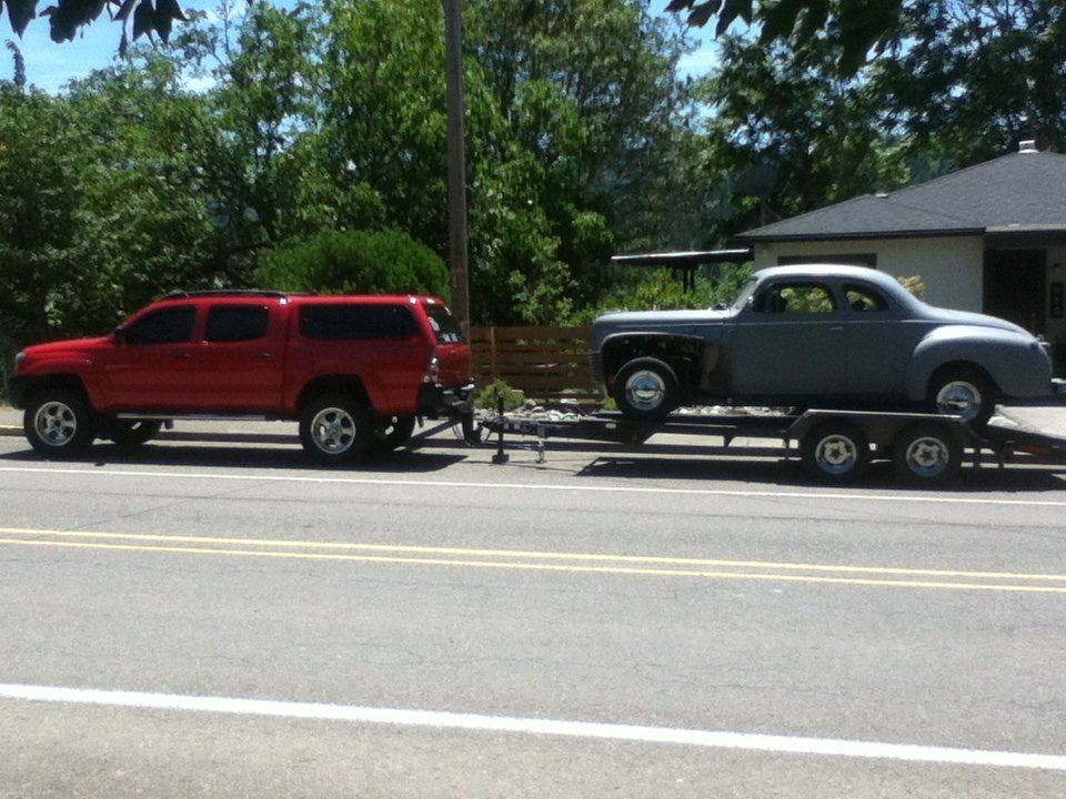

    Air bags, w/d hitch & sway control, drop hitch to keep truck & trailer level. They are very good things to use when towing heavy.

    good lookin set up there.

    Good look setup man. And yeah, I agree, got a good scale to make sure I stuck under the 650lbs. Dropped the loaded trailer in that parking lot and I'm sitting at 550lbs of tongue weight, right at 10%.
  11. Feb 25, 2018 at 6:58 PM

    Not sure what the weight was in that pic, but when I moved from AZ to OR, the trailer was ~6500 and another ~500 in the bed.
    I dont know what the pressure is, I have an automatic leveling setup.

    2014 SR5 DCSB V6 6MT 4x4
    I'm sure it'll be a long, slow trip either way. I'll feel a lot better about the trip being level and having full use of the steering and brakes.. the more I read on the WDH it seems like it'll add some nice sway control into the mix as well.
