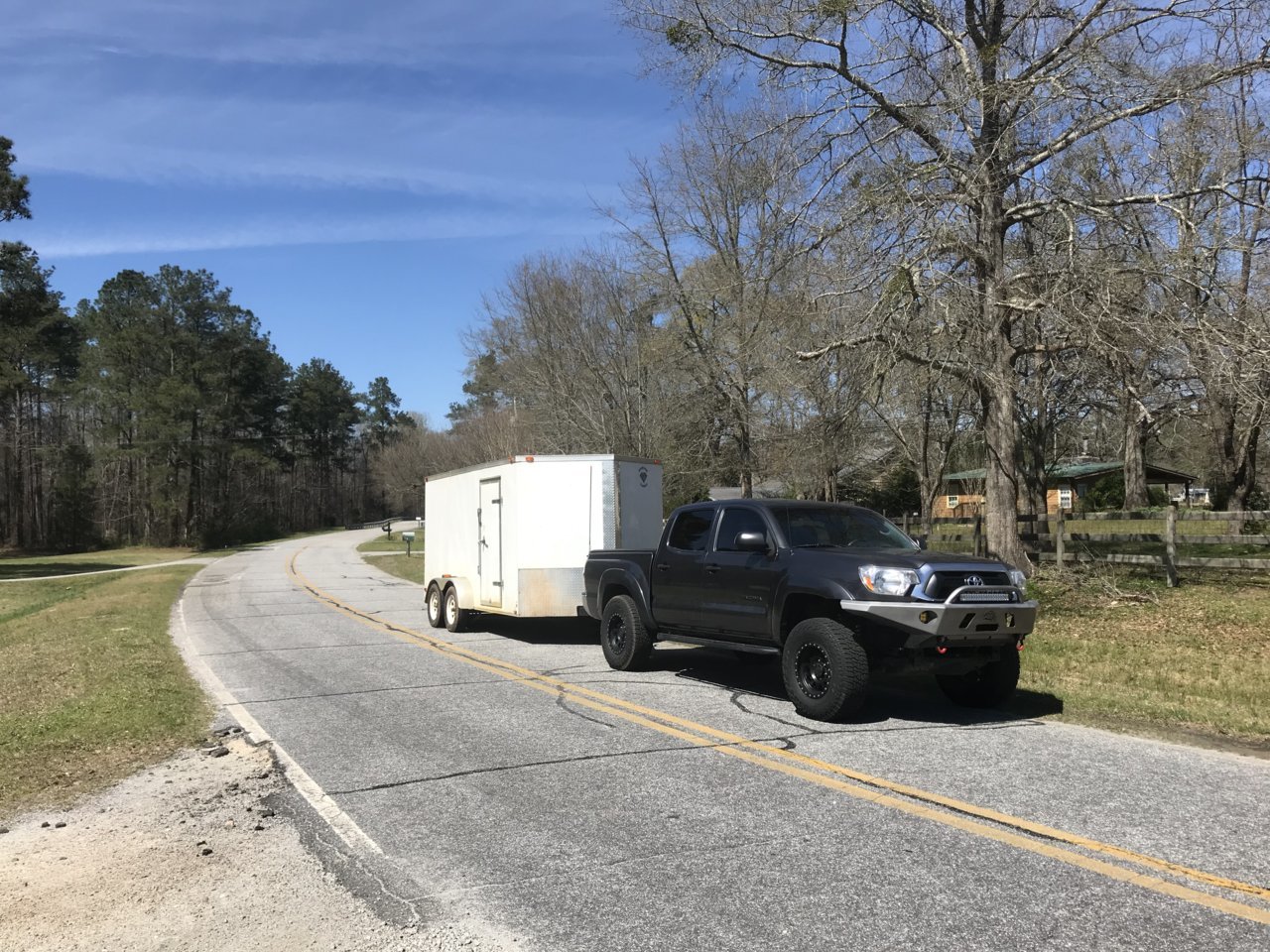

    yes, I have searched and read lots of posts, but what I've found is 1. most people were just saying what they read and had no real experience 2. people were trying to use a supercharger to tow things more than the Taco really should have, and 3. just get a big truck
    So, I'm hoping to get some real world experience before I even ask management (bride) for supercharger money. I have a 2013 Taco, auto, OME, 4.56 gears, and some extra weight with ARB bumper and sliders. I have a 2011 Gulfstream Visa travel trailer which is 19 feet long, dry weight of 2977 lbs and GVWR of about 3800 lbs. It is more aerodynamic, but still a travel trailer with a large profile.
    I have towed this trailer with stock gears and now the 4.56 gears. Let's say it's just OK. I travel in 4th at 60 mph at about 3000 rpm.
    My plan when I retire early in a couple of years is to use the Taco for exploring back roads and lighter 4 wheeling, and have the trailer as a nice base camp sitting in the campground. I don't need to go 100 mph, or do 0-60 in 7 seconds. What I am looking for is an enhanced towing experience. I want to use the Taco for his offroad maneuverability, but be able to comfortably tow the trailer.
    So for those of you with supercharger towing experience, what say you? Note the 3000 rpm in 4th gear and anything you can say about that. Responses are very much appreciated.
