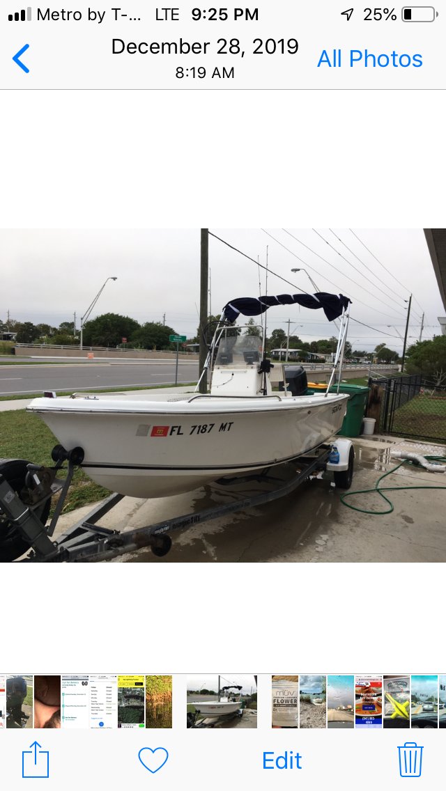

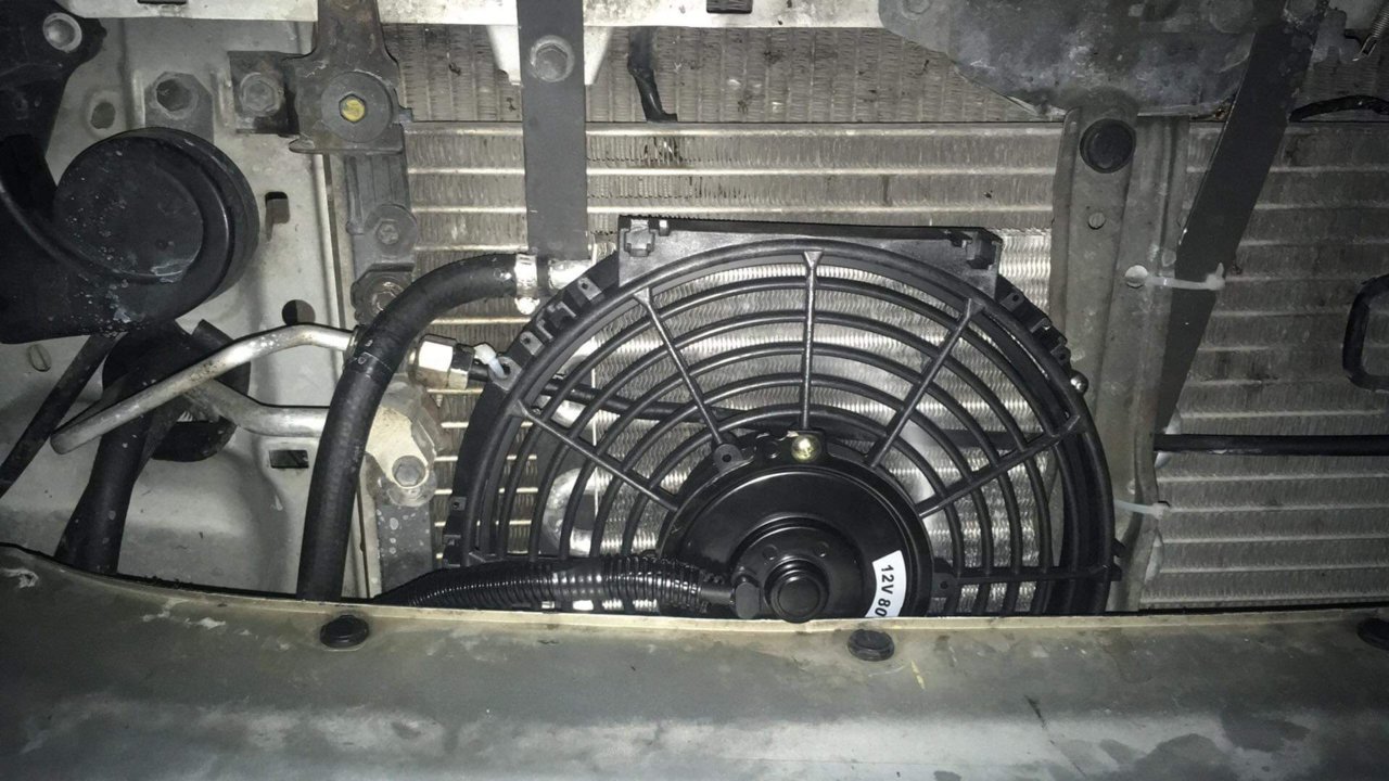

    Defiantly some good reading here tonight. I’m towing 2364lbs with 2.7l dbl cab. My boat is 17.2ft and is low. Air resistance will be a big factor. Towing in Florida only here, flat grounds. Overdrive is always off and 3200rpms has been my magic number. Transmission cooler is a must and aux fan is nice for stop and go traffic when airflow is minimum. I’ve recently added 1500lb over too leaf helpers to assist weak springs. Looking into sumo- springs / timken progressives. Like others have mentioned, a Pillar-pod and a temp probe in the pan is the safest bet to see what the truck is going to handle. Merging interstate with my foot to the skinny I’m lucky to hit 55mph. Not the most comfortable tow set-up but it’s what I have

    Im planning a big trip to the keys and want to know the 250miles each way will be okay for my truck. Looking into finned oil cooler by csf but they are pricey. Pillar gauge is next. As of now my max haul has been about 65 miles each way and engine temp hasn’t changed. Also, since I’ve started towing I’m now following severe duty truck maintenance. Brake/power steering every 30k and Toyota atf every 50k.
