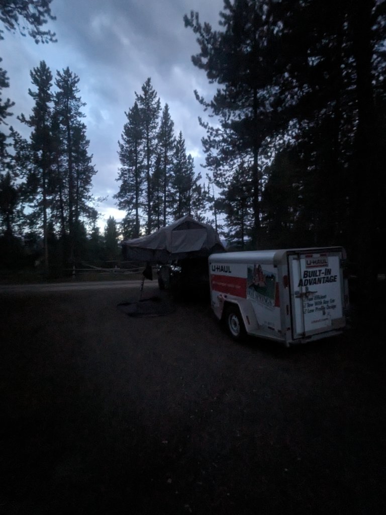

    Went with the Kurt brand and had uhaul install it for me when I picked up the cargo trailer. Went with the second smallest option and packed it damn near full. Drove 2,000 miles and wasnt too annoying until you got to higher elevation and steeper hills (VA to WY). Coming back I went with the smallest option trailer (pictured) and really wasn't too bad with ECT PWR. That trip was much longer since I crossed 3 national parks off the list. Think it is important to note that I had the OTT
    GSDtruck[OP] likes this.
